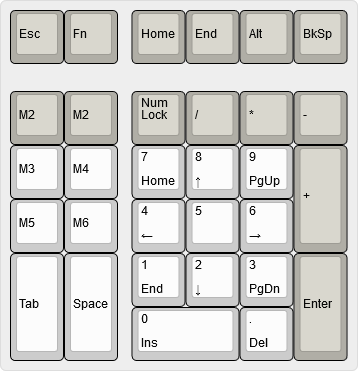

8/1/2016
Which is better?
I like the version with a 0.50 gutter between the Fn row.  It matches my Sigma.  The 0.25 version is exactly square.  Not sure if that is an advantage or not.
I want to add much more LED capability to the board, and possibly the ability to do full 6x6.
Update 8/2/2016
I think the square gets the vote.

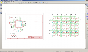

Okay so I've got a schematic.  Basically takes the goodness from my Sigma and applies it to the pad.
Now the entire top row contains individually controlled LEDs and there are underglow backlights.
144153-2
Going to be a tight fit on the PCB, but a challenge is fun.

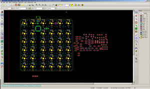

144177-3
Just starting to lay it out
Update 8/6/2016
Struggling a bit with the layout.  I'm finding that if I want a minimum size PCB, an option for full 6x6, and my usual front-facing LEDs, then I can't fit PCB-mount stabilizers.
So what is the collective knowledge of Geekhack?  Should I increase the size of the PCB to equal the v1 board and flip the LEDs upside-down, should I forgo the option to replace the 2u keys with two 1u keys, or should I nix the PCB-mount stabs?  Right now I'm strongly leaning towards plate-mount only like the rest of my boards.

« Reply #1 on: Mon, 01 August 2016, 20:57:10 »
Visually the .25 looks nicer, but only next to the Sigma the .5 probably will.

« Reply #2 on: Mon, 01 August 2016, 21:01:25 »
This is pretty much exactly what I wanted to do for a numpad/extra keys pad. I like the .25 better visually like the other reply.

« Reply #5 on: Tue, 02 August 2016, 06:18:30 »
 :D
I like the one on the left.  Embrace the square!
Re: QazPad v2
« Reply #6 on: Tue, 02 August 2016, 06:27:32 »
I like the left side more. It looks more custom somehow.

« Reply #10 on: Tue, 02 August 2016, 13:48:55 »
Also, finally saw the pics on my computer. I like the one with the wider gap, so the one on the right.
Are the switches movable? Might be a bit difficult to source those extra long num pad keys on the left, so wondering if we can use all 1u keys in that cluster.

« Reply #17 on: Sat, 06 August 2016, 14:40:50 »
More questions for interested parties in OP
Re: QazPad v2
« Reply #18 on: Sat, 06 August 2016, 14:56:22 »
My personal taste is to increase the size and allow 1u keys.
Re: QazPad v2
« Reply #19 on: Sat, 06 August 2016, 16:18:19 »
Yeah I would say increase the size of the PCB slightly. I think we really want both 2u and 2x-1u options, as well as PCB mount stabilizer holes.

« Reply #20 on: Sat, 06 August 2016, 18:01:02 »
the problem with the 1u keys isn't the size of the PCB, it's the stabilizer holes.  They occupy the same space.
Offline Data
  • Posts: 2608
Re: QazPad v2
« Reply #21 on: Mon, 08 August 2016, 07:49:19 »
You're saying stab holes and LED pads are in the same places in the layout?
Edit: Looks like Ron got around this on the GH-122 PCB by just flipping the orientation of the stabilizer so the larger cutout and the wire are on the opposite side of the switch from the LED.
