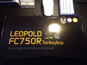

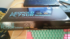

1. Two boxes are not identical.
151010-0
151012-1

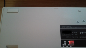

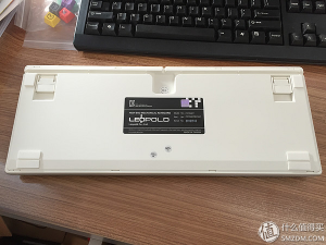

2. Mine doesn't have this bevel or antislip pads near the bottom edge at the back, while the other one does have this nice feature that provides additional slip resistance when the feet are unfolded, and that's how I use every keyboard I got.
151014-2
151016-3

His should have the liner if you look closely you can see in the pic that the box says "sound adsorbing pad" underneath the headphone symbol.
Not sure about the anti-slip pads, I think they transitioned away from those as my FC980M(which just came out) doesn't have them, and my FC750R which I got a little over a year and a half ago does have the two slip pads. Of course this could just be due to them not putting that on the 980 for some reason so I can't say for sure.
