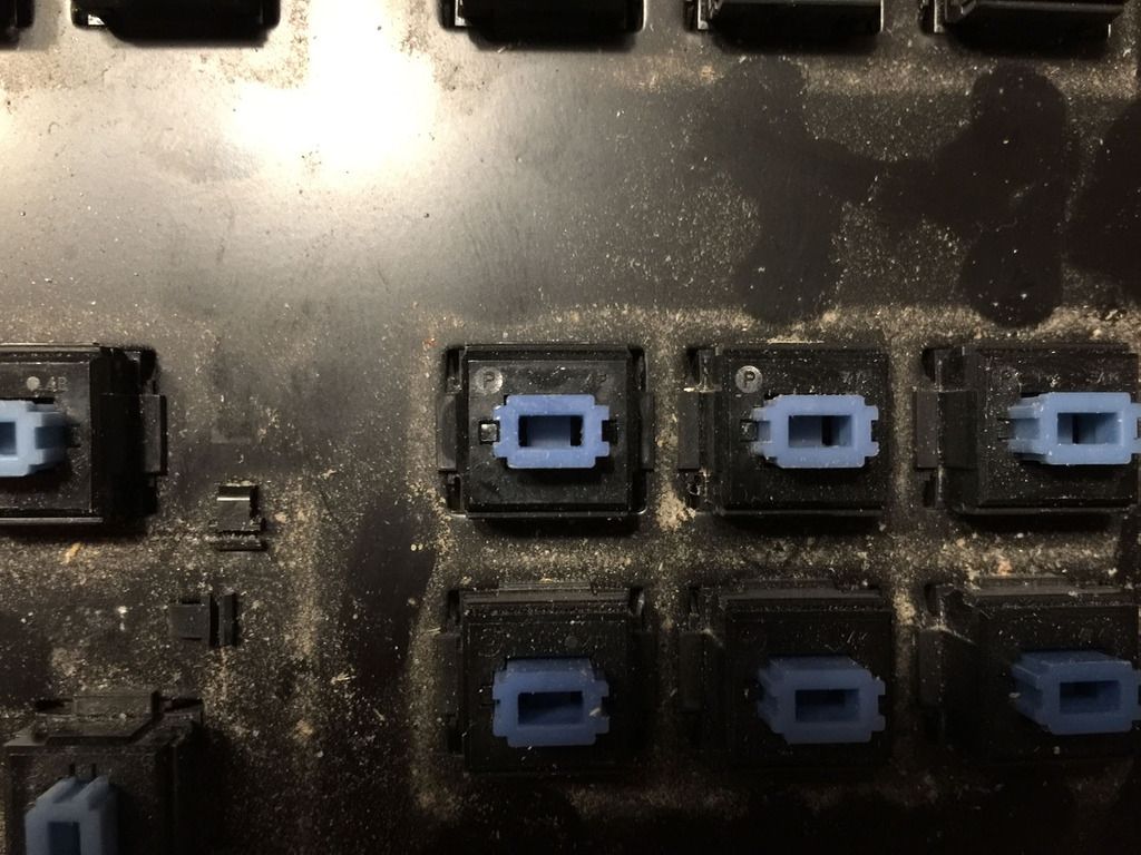

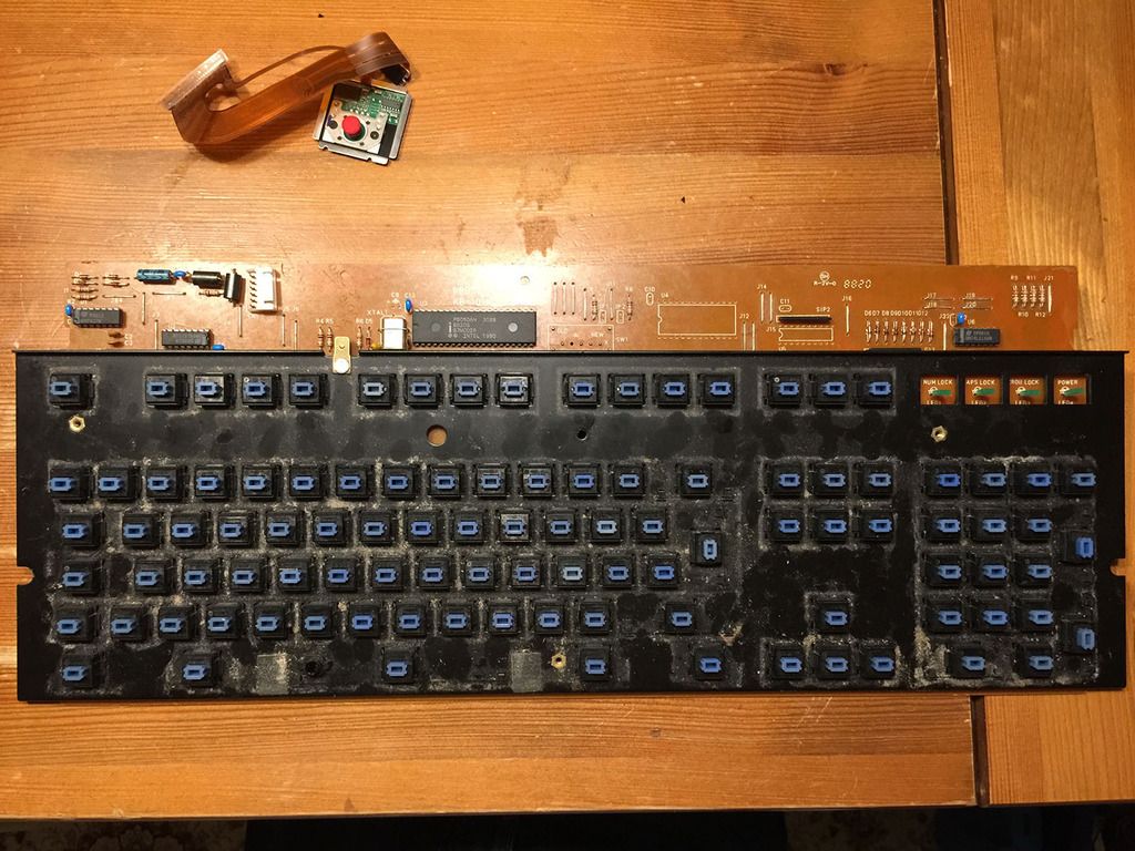

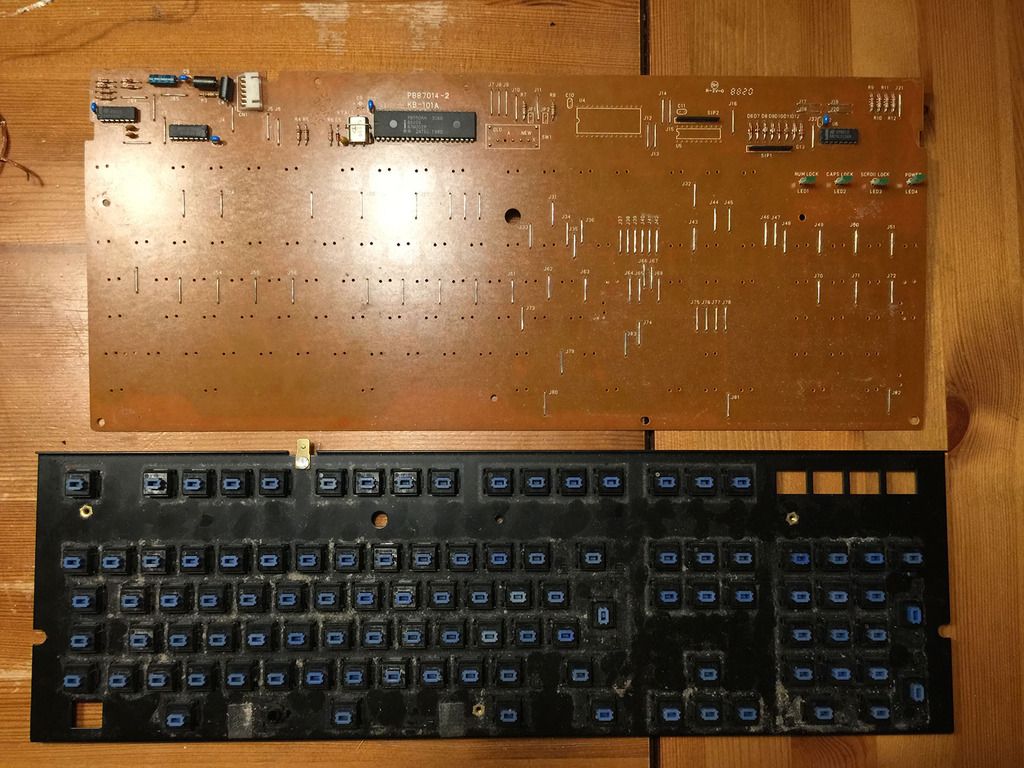

Got my hands on this broken vintage Acer keyboard, the case was cracked badly and the PCB seems to have some liquid damage.
Filled with dust :)

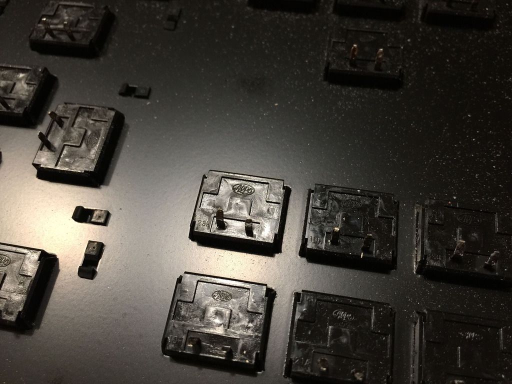

Desoldered all the switches from the PCB
Closeup on the ALPS logo

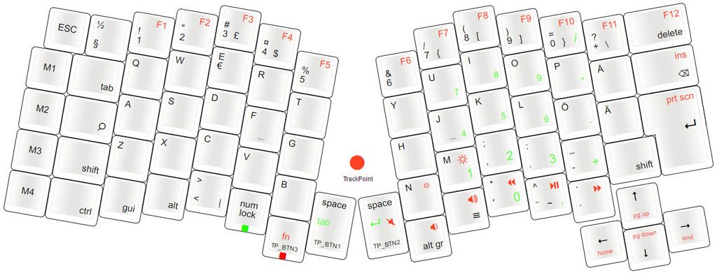

Did some research on what would it require to make a mechanical keyboard by myself and after looking tons of different types of diy keyboards, I decided that Atreus styled keyboard would suite my needs best, but wanted to have some extra keys on it and a trackpoint.
I was thinking of this kind of layout and keymap. Any thoughts on that? The numlock and fn keys would be layers (momentary) on the tmk firmware.
