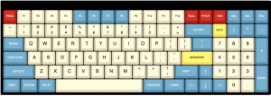

Hello everyone, new to the board, but I went through the posts, looks for a reference to the picture of the God Speed keyset attached
160034-0
A sort of part-75%, part numpad-yes keyboard, that would be an ideal combination to me. I was wondering, now having seen this, whether anyone knew of any PCBs that came in this form factor, or if pursuing this meant hand-wiring for me?
I thought maybe the B.mini EX X2 PCB from winkeyless might be the thing, but it doesn't quite cut it with the right shift.

Re: What keyboard layout is this? And is there a PCB for it?
« Reply #2 on: Wed, 08 February 2017, 23:21:04 »
duck lightsaver
ZZ96
red scarf III
« Reply #3 on: Wed, 08 February 2017, 23:22:09 »
duck lightsaver
ZZ96
red scarf III
The Lightsaver is potentially doing another Group Buy run soon when the other Duck GBs are finished. Check the Lightsaver V2 GB thread here -> https://geekhack.org/index.php?topic=56877.0

Looking at the Phantom PCB,
160049-0
There are multiple switch mount points where the shift key is (right shift); having never build a keyboard before, would it be possible to use the extra switch mount points to split the shift up into two keys. Something like [shift][uparrow]. Then the Phantom PCB becomes an option too?
« Reply #5 on: Thu, 09 February 2017, 13:15:38 »
Phantom PCB is meant for an 87 layout, not a 96. Split right shift is an option, but there are no cases that exist to allow a phantom to convert to 96.
« Reply #6 on: Fri, 10 February 2017, 15:31:13 »
I realize I wouldn't be able to get the full 96 out of the phantom. But if I could split the shift. I could do a layout like the one I designed here (attached) is that at least possible? It would more than suffice for me!
