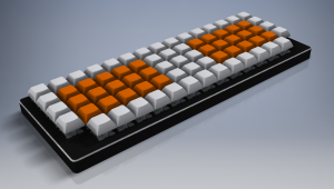

This is what I've come up with initially:
157795-1
157797-2

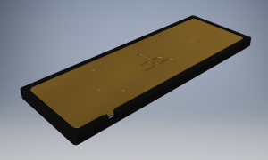

The top is milled, probably from Aluminium, and acts like a 5mm thick plate. By making the case the plate, there are no visible seams on the outside, which I found to be an interesting idea. That way the case is also usable without the bottom, so if funds are too tight to get the bottom made immediately, I can already type on my new board and get used to the ortholinear layout.
Bottom is from brass. It could also be aluminium, but brass looks bad-ass and gives that nice heavy feeling. Fun fact: half of those screws are faux (they're not actually holding the plate in place) because the mounting holes in the PCB are anti-symmetrical. This might confuse me at some point in the future, but it just looks nicer this way. Maybe small marks in the plate would help with that. Something like dotted rings around faux screws and solid rings around structural screws.

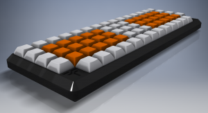

When posting the pictures to r/MK, someone suggested to make the case high-profile. I am using an HP case right now as well, but this one just looked stupid.
157799-3

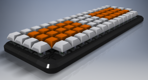

It looks like a brick. Not really a fan. I tried to see whether I could salvage it in any way, maybe with undercut chamfers,
157803-4

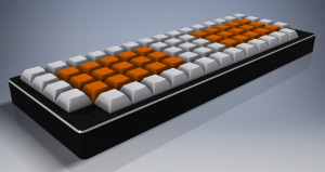

but in the process I mainly managed to make the low profile case look even better:
157801-5
So that's where I'm starting this thread off now. What I am missing is some way to tilt the case up, or at least some place to add such an option later as I don't think I'll be comfortable with 0° angle.
Any criticism, comments or ideas are appreciated.

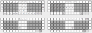

Firmware in QMK is done, took the better amount of three days until I finally figured out a relatively simple solution.
157892-0

Haha jup, sure do! :) Thank you very much! I even got a small update in the form that I've now managed to properly program the micro. It took three days to figure out what the best possible implementation was because I wanted Shift to simultaneously change to a new layer and RAlt to do the same. Additionally, if both those keys were pressed, a third layer would be activated for even more obscure symbols.
But now I've made it and managed to perfectly replicate the layout that you can see in the first post. There's one small bug that when you hold Shift and press the numpad dot to produce a comma, holding shift will also "hold down" numpad dot. Not sure why that happens, but everything else works perfectly. I'll post a link to the github repository once I've put it up there.
