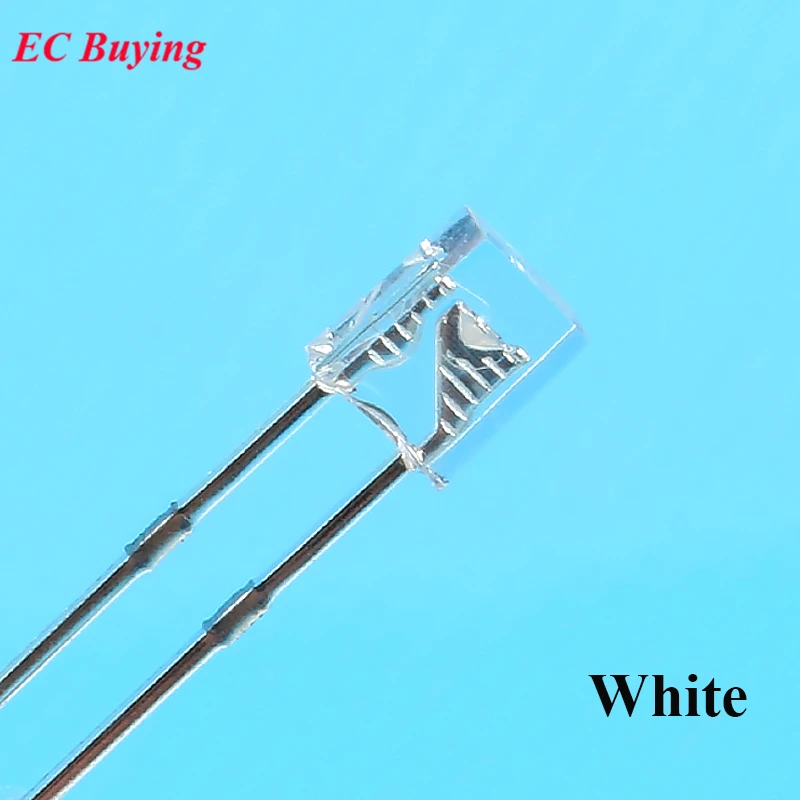

I am wondering where I can find LED lights for a keyboard? I have obtained a modded board that has had them removed (so the PCB can take them, it's a Miya Pro), and need to source new ones... but I am unsure where to look. Are they all made the same? I have no real experience with soldering, so I also have no idea if I'm getting in wayyyy over my head with this idea. Any advice is much appreciated, thanks.

You would need these ones 2x3x4 LEDS.
I came across these: http://www.maxkeyboard.com/products/parts-and-accesssories/led-lights/ but looking at the picture you posted these wouldn't be correct. They say 3mm, but the shape seems different, rounded, not square.
Also, you posted white, and I know the board originally came with white, but would I be able to use a different colour?

this applies to anything resembling cherry profile, so even if you like pbt if you're using ePBT or something you need 1.8mm
you can check polarity by looking at the bulb or the legs. normally the shorter LED leg is the negative end
