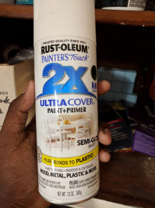

Looks slick.  What kind of paint did you use?
I used this semi gloss paint+primer thing. It seemed to work pretty well but I'll see how it fares in the long run. I'm most concerned about the plate as the keycaps will be banging away at that and I'm scared that the paint won't last much when that happens.
