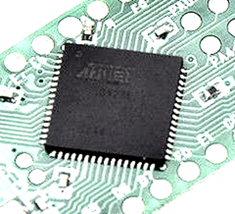

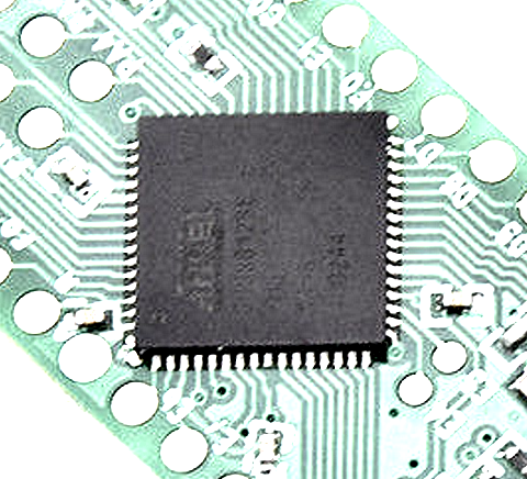

It does purport to use the same chip as the Teensy++ 2.0, a AT90USB1286, though in none of the pictures was the chip clear enough to read, which is another red flag for me.
Ha, "red flag", is that a China joke?  :?)
Here's the best I can do with enlargement and contrast enhancement:
Make any difference? You guys know more about this than I do.
Yes, it's a counterfeit, not just a clone, as the listing claims that it's a "Teensy USB development board")...
