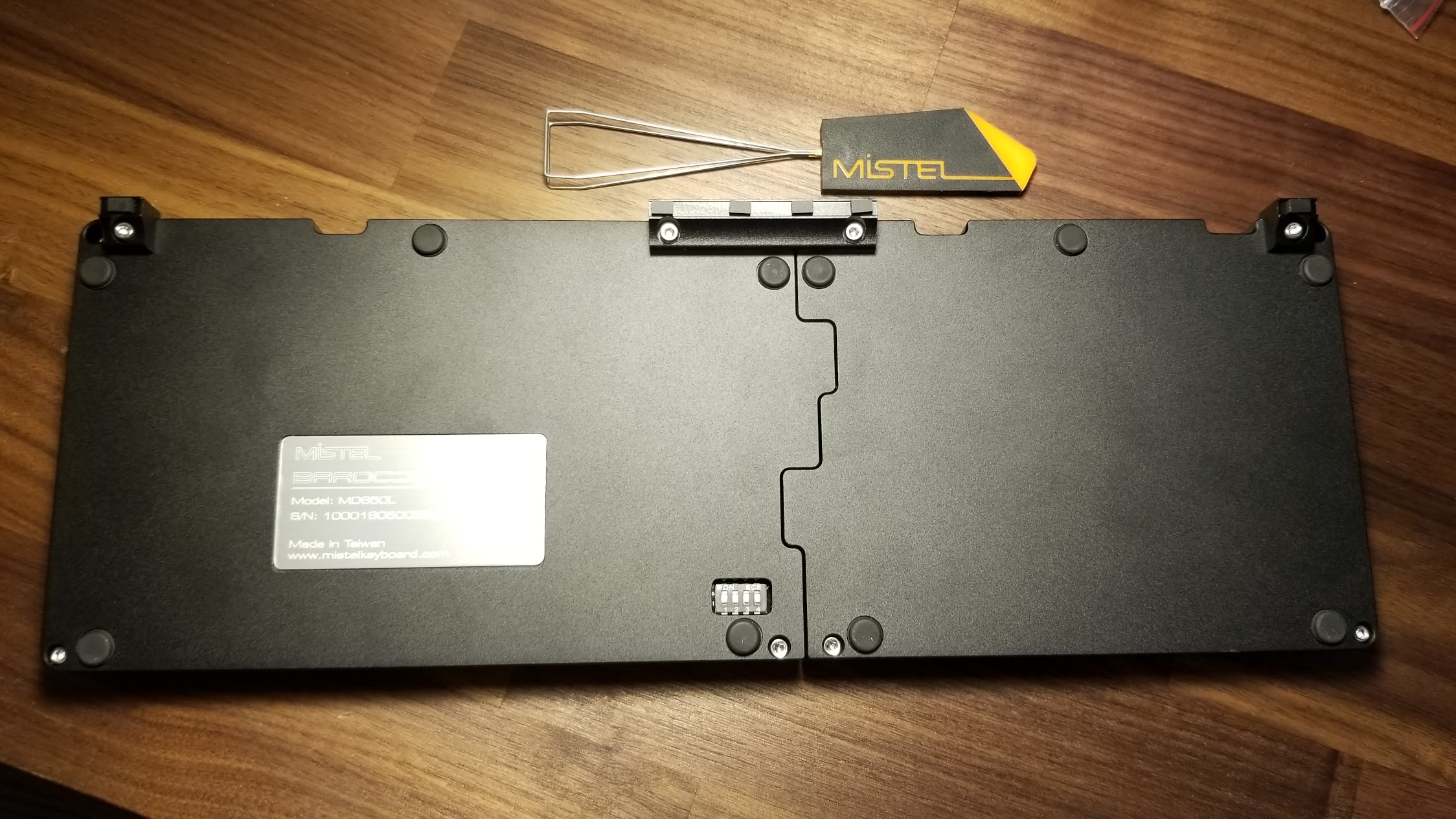

202799-6
Another smaller but still neat addition this time around is that you can combine both halves. It didn't click with me at first that this is what you were supposed to do with that long bar. I know, I know... But you have the choice between putting two small tilt feet on each corner of each half or doing what you see above. I attached all of my small tilt feet and then looked around wondering where the heck I was supposed to put the long one. A good dose of caffeine later and I realized that I was an idiot. It does work very well though when tightened all the way down and is a nice concession for folks who may think they want a split keyboard and realize after the fact that they were mistaken.
