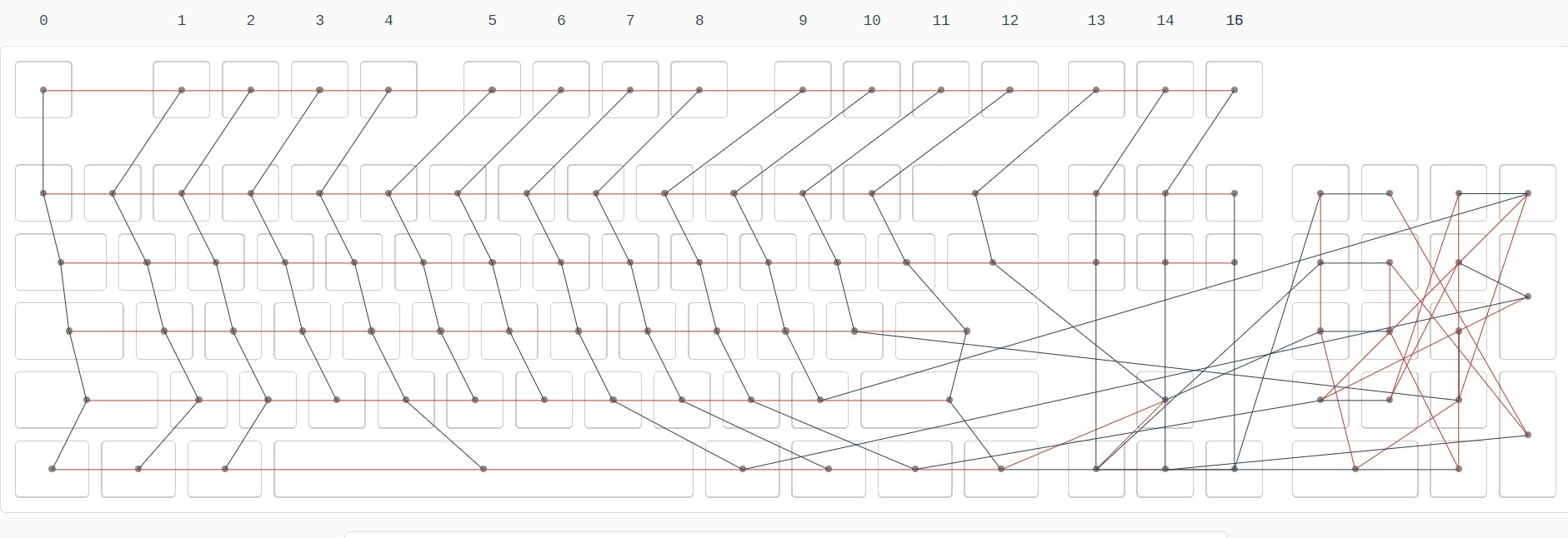

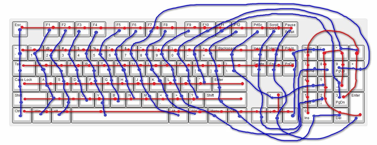

1.The trace (crazy Chinese wiring of numpad, looks optimal isn't it ?)
206178-0
Another look from Keyboard Firmware Builder https://kbfirmware.com/

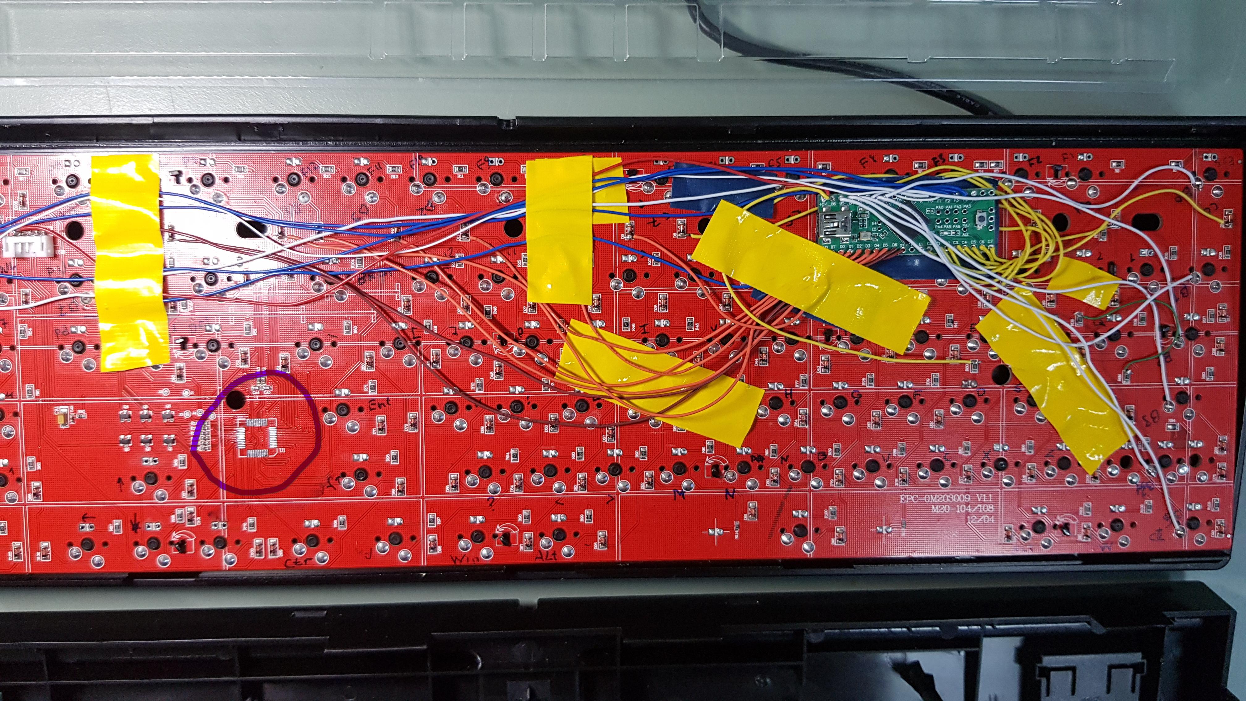

2. I`v removed old micro-controller. For new one I purchased Teensy ++ 2.0.
206182-2

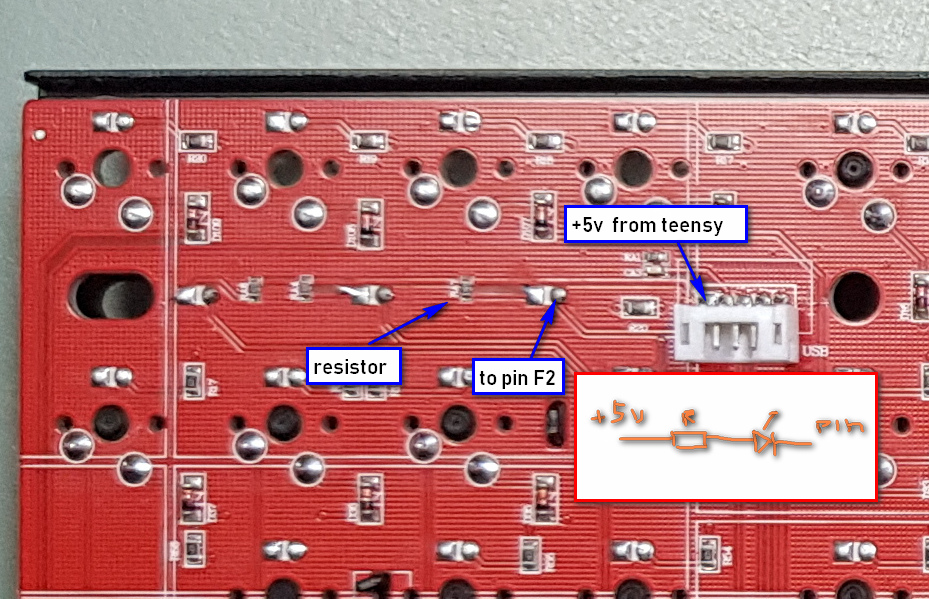

5.LEDs. Num Lock, Scroll Lock, Caps Lock
206184-3

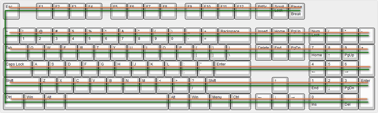

Trace of LEDs for backlight  looks like this:
206186-4
I`v used one pin (B6) only for WASD.

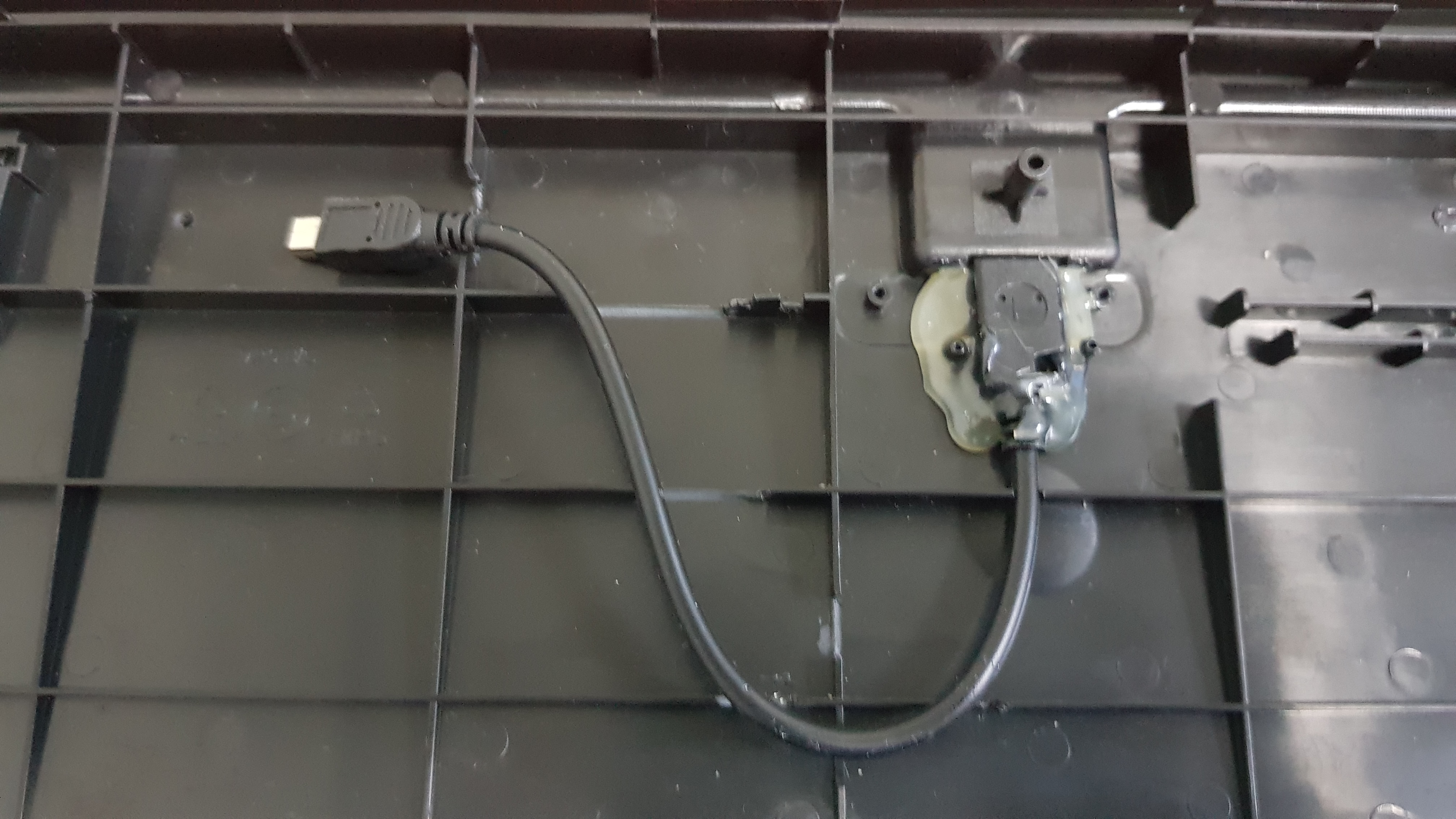

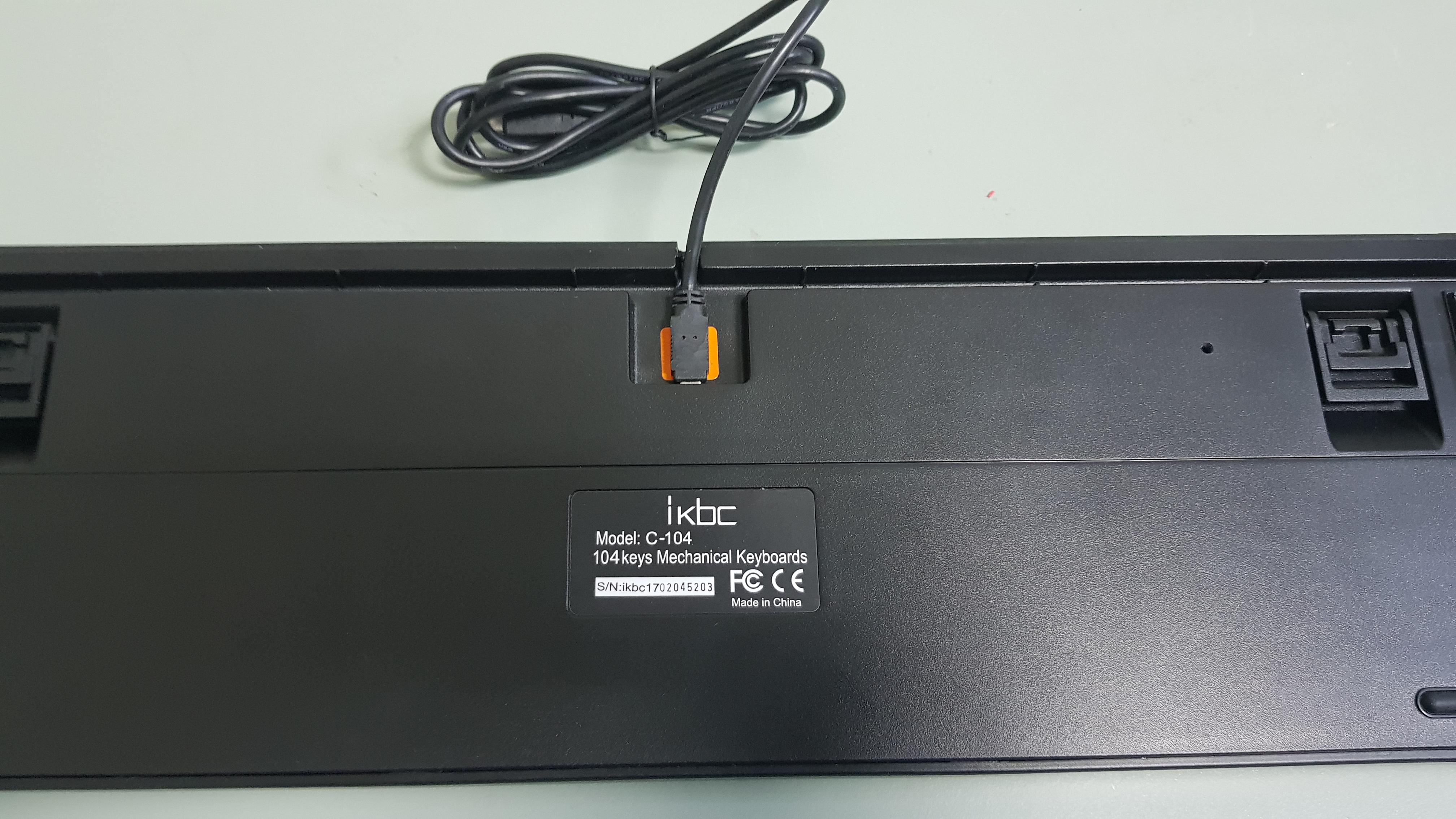

Mini USB cable (optionally)
206190-5
206192-6
The final result

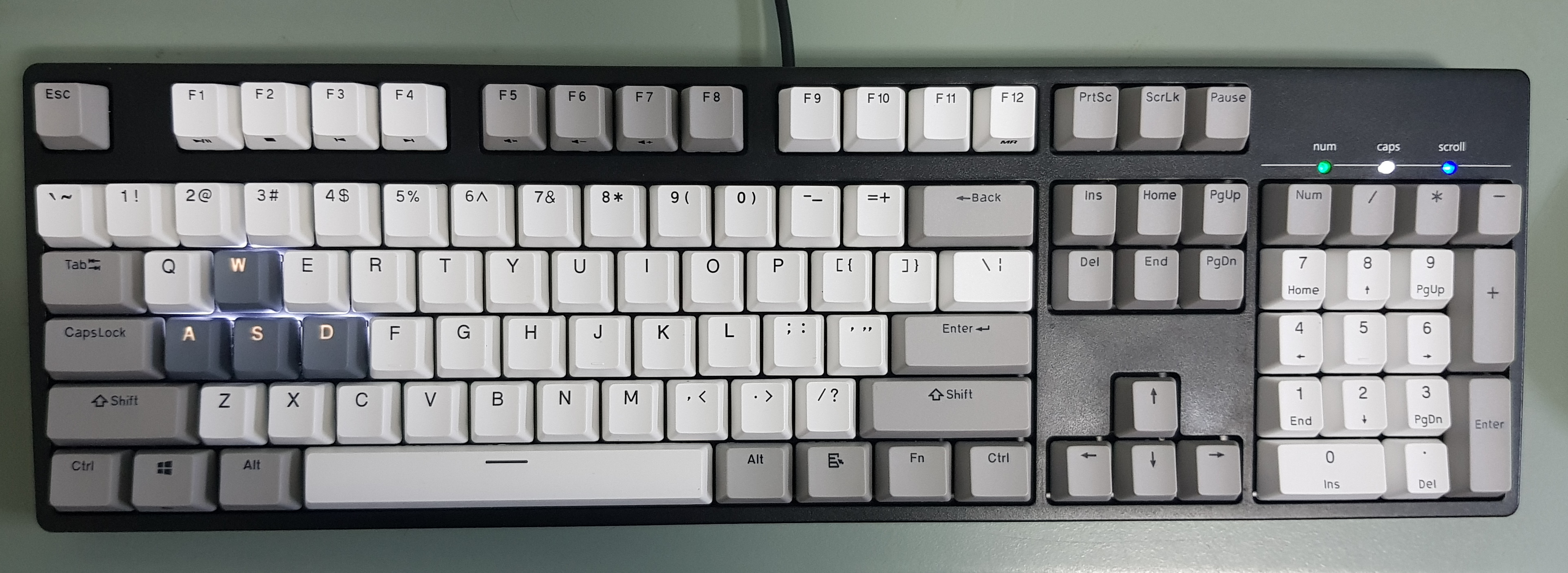

206188-7
The end
Hope it was helpful.
Not sure what I'd call this.  It's not optimal as 11x10 is enough pins if you can get your head round it, which from the number pad it looks like this designer could have.  My guess is he got bored or took something he shouldn't have towards the end :))
One thing I am curious about - it looks like the PCB supports ISO split left shift (which is strange as it doesn't have space for an ISO enter...) but Z is in the second column - is the extra key connected in 'below' C?

Little update .I added hebrew and russian legends by dye-sub. Many thanks to this https://brianjking.github.io/mechanical-keyboards/customization/idea23-dyesub/ project author.
