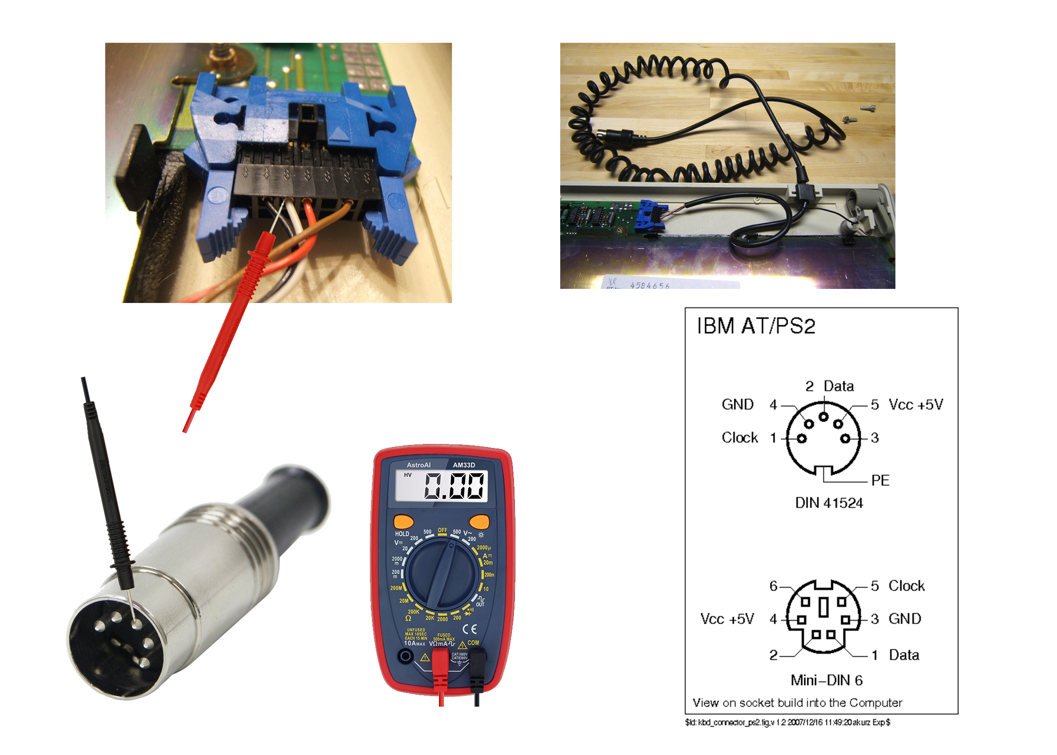

i have not seen the insides of every version of this keyboard, so your first step would be to open it up and see if you have the same blue connecter.  its the top two pictures here.   https://deskthority.net/download/file.php?id=47237&sid=88afce03798bb66ef7e6811218f09628
if its the same then  you could swap the cables, open yours up--there are 2 bolts but be very careful lifting the cover as the internals are not secured so they can fall out!  and then we can help.
if you want to try it yourself i suggest posting at deskthority as there is more of an active community there restoring these.  do not fear about building it, the parts are very cheap (less than $10), so even if you fail, it's a low cost lesson.  but if you follow the instructions its very straightforward to build.
if it were me i would make an internal converter and save the cable conversion for alter when you are able to source the correct parts or better understand the wiring.

Thanks again for the detailed reply! I must say, I'm certainly not a newbie when it comes to the Model F - I've had five XTs, and done a fair bit of disassembling. The only thing I don't understand is the electrical stuff, or how to get them feeling optimal once they've been opened. I've messed up a few, because they feel terrible after opening them or replacing the foam mat. :/
But if the 5155 Model F cable can be unclipped from the controller like the PC equivalent, I'll switch around the cables and call it a day! I think I'll nab that clean one off Ebay, as soon as I can afford it. If not, I'll work on an external converter and refer to this thread! Cheers for the advice, guys.
I am only tempted to get the 5155 keyboard because it looks nicer than the XT and will sound better (due to the plastic chassis).

Thanks for linking that! Looks like I should just be able to unclip the cable then! Brilliant. :)
