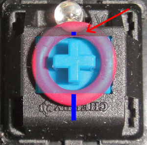

Previous experience has taught me that crème de la crème for my fingers means OEM thick PBT with o-rings.  With Cherry profile the o-rings reduce the travel too much.  The OEM keycaps must also have the normal design on the bottom with all 4 struts that support the stem.  Many keycaps have one of the struts that support the stem removed, and as a result the o-rings cause the keycap to slightly tilt and wobble when bottoming.  As can be seen in my picture below, normally the o-rings make contact with the base of the switch in only two places.  The hole of the piston is too wide, so the left and right sides of the o-ring don’t really make significant contact with the base.  As little as it seems, it is adequate.  With keycaps that have only 3 struts, however, the top contact where the red arrow is pointing is missing.  Some keycaps don’t have any struts, and they also cannot be used with o-rings.  After some searching and after I was told that the new Leopold DoubleShot PBT are OEM profile with all 4 struts I placed an order for 2 Leopold FC900R.

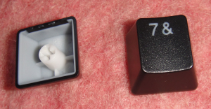

4 struts:
185951-2
3 struts:
185952-3

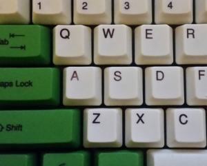

- I bought these keyboards primarily for the keycaps, and sadly they have Cherry profile, or very close to it.  I was told that they are OEM, but looking and putting my fingers on these keycaps made me forget about their profile in an instant.  These are by far the most beautiful and well made keycaps I have ever seen.  Thick DoubleShot PBT with the whole keycap actually being PBT, an elegant and non-distracting font and really the perfect surface texture, not too smooth, not too rough.  I could not see any seams or difference on the surface of the keycap between the legends and the rest of the keycap.  The texture at the top of the keycap is one completely uniform surface.  This is the pinnacle of quality.

The first time I tried the Leopold I was surprised by how quiet the keyboard is.  My immediate thought was that it sounds exactly like my Ducky One with thick PBT and rubber o-rings.  The more I typed on it, the more I felt that something felt distinctly different.  On closer examination, I noticed that different keys feel and sound differently.  The following photo shows the bottom of six keys that I’ve removed from each row of the keyboard.
188780-4
They have slightly different height, but more importantly the 4 struts that support the stem are slightly of different height, and in fact the keycaps on the 3rd row all have only 3 struts, because they are not tall enough.  It is my belief that the way these keycaps are able to absorb the sound and harshness when bottoming is by hitting the top of the key switch with the 4 struts on the bottom of the keycaps.  The contact is still plastic on plastic, but because there are 4 contact points and they don’t all come in contact with the key switch perfectly at the same time, the sound and harshness is softened.  On a keyboard with OEM keycaps, when a key is bottomed the contact at the bottom of the travel comes from the piston of the switch hitting the bottom of the switch casing which rests firmly against the PCB.  When these Leopold keycaps hit the top of the key switch, some of the sound/harshness is also absorbed by the top casing of the key switch.  The problem with this keyboard in particular, and it might be with other cherry profile keycaps, is that there is a very obvious inconsistency in sound and feel between the keys on different rows.  The keys on row 3 are completely dampened, with a noticeably shorter travel, keys on row 1, 2 and 4 are dampened but with little to no travel reduction, while most keys on row 5 and 6 sound loud and crisp, same as if they have OEM profile.  I don’t have a way to measure it, but I think the reason the keys bottom differently on each row is that the struts that support the stem are placed at slightly different distance from the end of the stem, especially on the 3rd row.  Furthermore there is a slight but noticeable tilt or wobble towards the front when bottoming the keys.  This is similar to the tilt that happens on OEM keycaps that have 3 struts that support the stem with rubber o-rings installed, except the tilt is in the opposite direction.
Edit:  The reason I was experiencing this problem I found later was due to using the Leopold PBT keycaps on a Ducky keyboard.  It turns out Cherry profile keycaps have to be used with switches LED side facing south in order to bottom out properly.  I did try the FC900R, but since it was only available in red switches my intention was to simply use its keycaps on my Ducky.  I just saw a youtube video with blue switches on a FC900R, and clearly the keycaps don't have the problem that I was experiencing with the inconsistency of travel and sound on the different rows of keys on the keyboard.

These caps don't seem to be translucent/have windows to see the LED indicators for caps/scroll/num lock, but I see the blue & grey version of the fc900r do have translucent keys. I want to buy this board for my dad and to put the enjoypbt hangul caps on for his work desk, but he wouldn't be amused if he couldn't decide if his caps lock was on when he's logging in first thing in the morning. Can anyone clarify if these green caps have the little LED windows or if the user just relies on backlighting under the lock keys?
