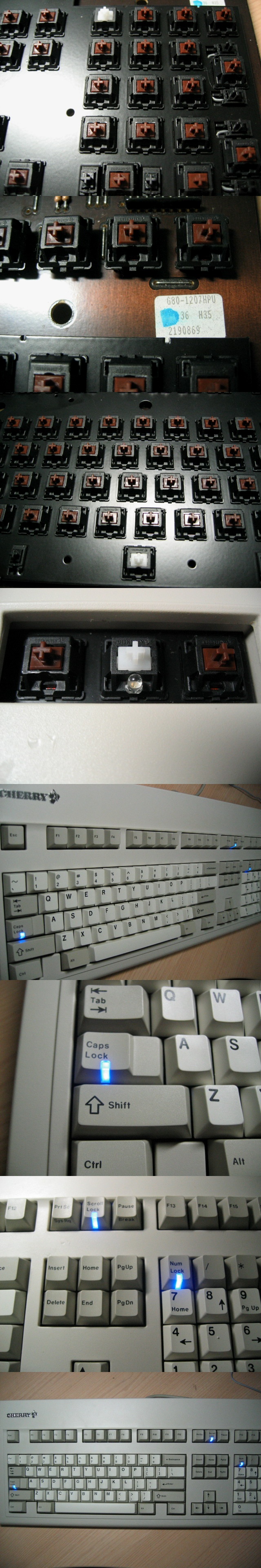

Hi,
The Cherry G80-1295 HAU keyboard i bought is pcb mounted cherry mx black switches.
I also just recently bought a NCR 3299-k440-v001 g81-3007 SAU/01 which is a Cherry MY board with Dye sublimated keys. I'm harvesting them for the dyes, but i also happened to notice that it has a metal backplate. Would this be able to fit on my 1295 board which also seems to be the same 101 US ansi layout ?
http://park10.wakwak.com/~jpspace/key/kaitai_g81.html
Also does anyone have a step by step guide how to do this, or what kind of level of difficulty should i expect ?

Unless you have high precision laser cutting equip or a lot of free time and godly skills with a dremel, this aint happening. The plate mod I did with the g81->g80 is only to add stability to the otherwise flexing PCB. Switches remain PCB mounted of course.
The  Korean mods use custom plates that they had made with cnc laser cutting machines.
The Japanese mod uses a custom plate that is available from a Japanese online shop, its made of solid steel. Price is $140 for the plate with no keyboard.
« Last Edit: Mon, 07 February 2011, 00:23:38 by sixty »

Comparing the back plate pictures vs the G81-3007.
The cherry mx switches have larger boxed shaped holes, whereas the cherry MY plate only has diagonal holes for pins. So it's not gonna be cherry mx compatible unless i also make box shaped hole as well my guess ??
So its either
1. make square shaped holes
2. or settle for your Sixty's mod where he used the G81 plate behind the pcb with some rubber mesh to partition; but it's still pcb mounted at the front.
Option 1 seems it's going to be difficult getting the cutting accurate ... I initially thought only 2-3 holes required to get it to fit into the plastic place holders. But now it seems it's escalated to having to make many square holes, and they need to be accurately cut.
Option 2: not really gonna be that much difference to me. G80-1000 casings are much better plastics than 3000 series aren't they.
So i guess the best choice is the Japanese or Korean custom made mounting plates Sixty mentioned. I wonder if they have been tested as G80-1000 compatible ? Does anybody have these links ?
And another thing, the switches originally on the G80-1295 HAU are pcb mounted. So my choices are
1. cut off the plastic pins so i can solder them onto the metal plate
2. buy cherry mx switches that are already designed for plate mounting. (but in this option, is it possible to transplant the nkro diodes from the original pcb mounted switches to these new ones that don't have the nkro diodes ?)
