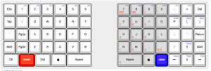

Hi,
Your project can be considered different of mine but there is some relation.
Here is some renders with keyboard layout editor.
The bottom size need to have big keys for use them with the palm. Also I love the position of the fn / right ctrl key on my render for use them without moving my hands.

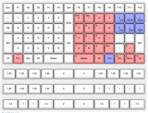

You can make up the bottom row however you like. Especially when going with alternate layouts, "looks" are usually the least of the concerns. It's definitely more about functionality, comfort and creating something that doesn't exist in the wild yet (even if it is a minor change over what's currently available).
Look into function layers, you can add all your secondary navigation (home, pgup, etc) on a layer so they don't need a dedicated key. Take a look at 4sStylZ layout as well as what macroxue has put together as far as Fn layers.
One added bonus about going ortho... it makes it super easy to add a number pad on a layer.
You can see on the example below... bunch of bottom row options. (1.5 mods are not as common as 1.25 mods) especially if you are hoping legends to match. i also put in two Fn layers to show examples.
225588-0
And this is the layout i run on my Keeb.io Viterbi (the rev.1's had an option for 1.25 modifiers)
225590-1

Thank you very much for your answers...
(ou Merci, car j'ai vu un utilisateur BÉPO ;))
@nevin: I only have access to 1.0, 1.5 and 2.0u caps, no 1.25u, and these will be blank, so no problem of matching legends
but I really like your option of going ortho with layers for a keypad and navigation keys and will probably try this at first.
Because I plan to make a PCB, I could try to allow several layout options for this row... I'll see ;D
