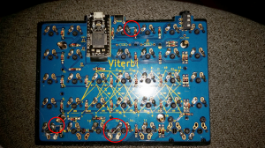

circled in the picture below, you can see a couple jumpers i have on my old viterbi (well used, abused & LOVED)
- i used the clipped legs off of diodes or resistors, but any small wire will work as well.
276200-0
and if the pad pulled the whole way off, you'll solder a jumper from the swtich leg to the next pad that the trace is supposed to connect to (usually a diode or the next switch, depends on if it's the row leg or the column leg of the switch that's missing a trace)

I have heard about this method of jumpering broken pads, thanks a lot for the photos they will help a lot. I will take a look at the PCB traces, do I need to remove some of the solder mask to do this jumpering?

No, you don't have to scrape traces to make a place to solder to.
You jump from the switch leg to the place the trace should have taken the connection to (the diode, or the next switch leg in the row)
Look at the pic I posed. you can see a couple spots where I ran a jumper from the switch leg to the top of the diode. Replacing the broken trace on the pcb. (Ignore the jumper (mess) at the bottom center, that was just a repair when I changed the bottom row layout).
...So you jump the broken trace and go from switch leg to the next pad in the circuit.
If you have smd diodes (tiny black boxes) instead of the orange/glass ones in my pic you can do the same thing IF that's the trace that's broken. You would need to add a little bit of solder to the end of the smd diode, then add in your jumper wire.
But you need to figure out what traces are broken on YOUR board.
And do not use lead free solder. It is soo much harder to work with. Takes a lot more heat to melt, etc. not fun... (regular leaded solder won't hurt you.   .....as long as you don't eat it)
