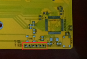

about the raw chip:
after soldering required components, you must "program" bootloader into it.
On the design, you must make program pins accessible, check this example:
232890-0
connect these pins to a "programmer" and use software to program bootloader into your MCU (the ATMega32u4, which is now soldered on your PCB).
cheapest option for a "programmer" is an Arduino ProMicro (which I'm currently using) and the software is avrdudess (you also need appropriate hex file to program the bootloader)
after you have programmed the bootloader, you can flash keymap into your keyboard via USB with qmk toolbox. (you need hex keymap file for this task)
