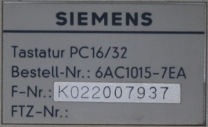

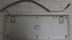

So I bought this thing on ebay for €50 plus shipping.

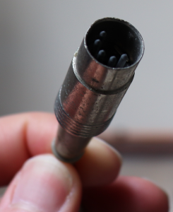

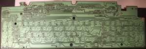

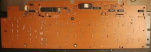

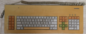

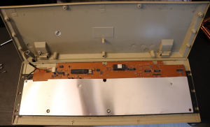

So the board seems to be some sort of AT compatible keyboard judging from the LEDs and the connector but it doesn't work properly with a cascade of adapters up to USB, and by that I mean everything you get from the board is random key strokes.
240509-3
As you can see, the case is very yellowed/browned but the keycaps are fine except for the space bare so we have probably some ABS/PBT combination here.
There is a double labeling on some caps that seems to be made with dye sublimation process.
Anyway this thing is dirty so you know what that means.
240511-4

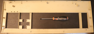

All the parts are screwed in place with machined screws and brass inserts.
240513-5

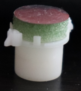

The switches looks like to be BTC foam and foil and are very very scratchy, hopefully a good cleaning will improve that.
The chassis is very rusty under the paint.

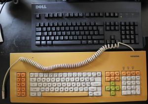

And there is the final result and a Dell AT102 for size comparison.
240533-15
The switches are way less scratchy than before but that's not perfect. I think applying some grease would help a lot.
Also I'd like to retrobrite it but I don't have a big enough container right now.
On a side note, the cable gained some ugly color spots after cleaning.
Overall I think this board looks nice and that's the only one I have right now with that kind of switches so that's nice.
Anyone has suggestion on what should I do to make this work on a modern PC? Should I buy a Soarer converter?

Which adapters have you tried? My beige badge Zenith Z-150 doesn't work with literally anything, except for direct connection to certain computers with ps/2 ports. A Soarer's converter would be your best bet, if that didn't work, you could also flash TMK and try that.
I like to build my own, and that's what I would do in this case, since it could be using the XT protocol, and that might require an extra reset wire that's usually not present in converters unless they're meant specifically for things like the Leading Edge DC-2014. Some boards also do not like not having pull-up resistors.
