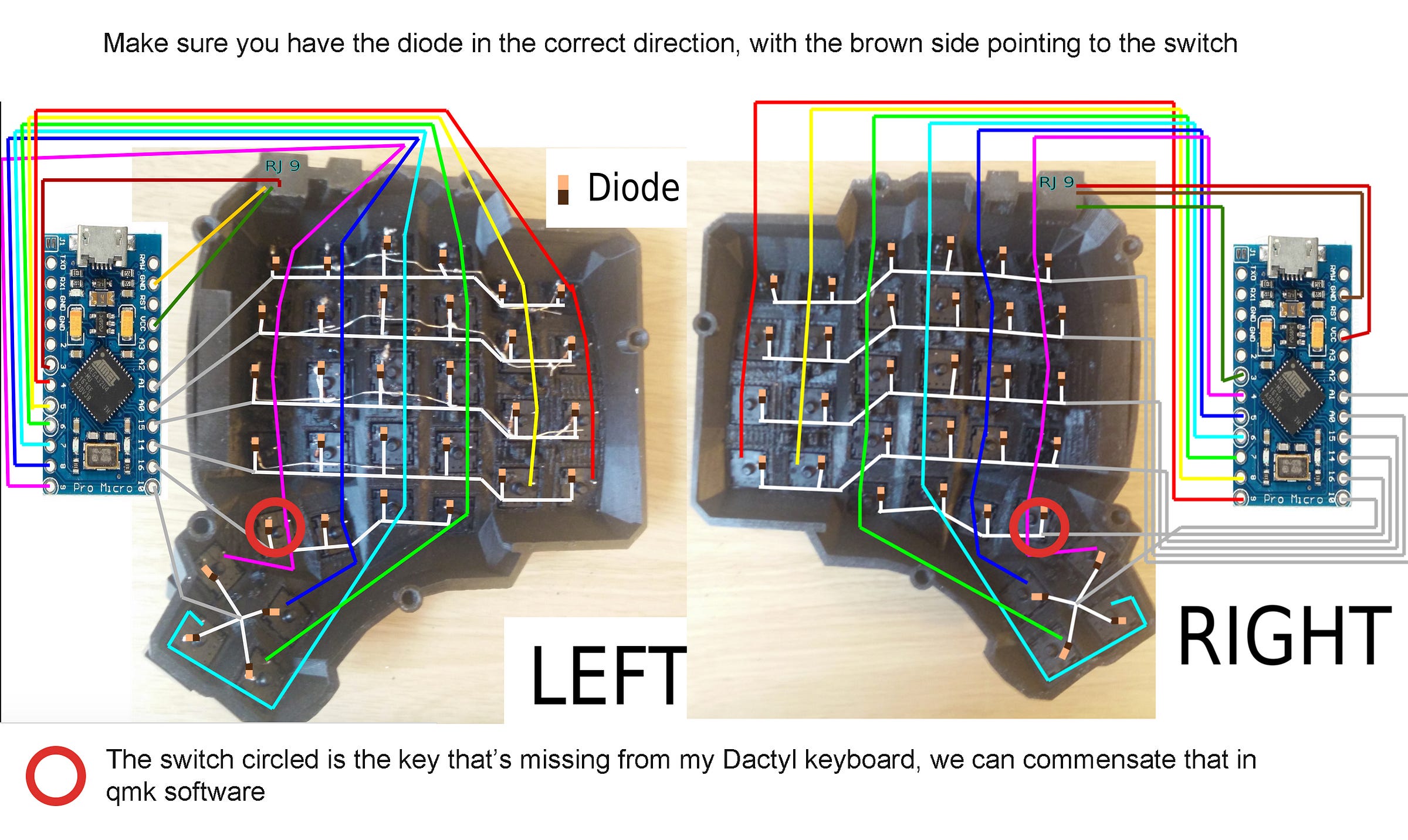

i was hoping for some help here with a dactyl manuform I'm trying to build (first hardwired build).
here is the issue. its ready but when I flash it with the 5x7 from qmk configurator it finishes the flash but nothing works. If i flash it with the left hand only i get two keys to work.
so I'm lost. It could be that i messed up the wiring to the pro micro ( I'm using a "bit usb-c"), I followed a guide for a 5x6 and had an extra column to figure out.
anyways this is my dactyl
cant find the keymap for it anywhere so this could be my problem ?
and this is the wiring I did with some modifications.
since i had an extra column i put that in pin 3 and the rj9 in 2 (thinking I could some how change that at some point)  more likely this is my problem ?

First of all, handwiring is difficult and sometimes quite unestable if not done properly. Be sure that you have good solder points, you can check this with a promicro, using a led and a breadboard and some wires, check the start of the column and the end of the row, if it lights when pressing then is ok or the problem is the promicro connection.
****ty diagram of the ****ty invention: https://drive.google.com/file/d/11Nkhe_AkVW-JqsjypgpDfKvgOHuQLNRr/view?usp=sharing
Second, if you have modified the default wiring, no matter how little, then you should download the qmk source code and modify it to reflex your changes, compile it and burn it. It's not that difficult.
If you upload some detailed photos of the real thing it'll help us.

since i had an extra column i put that in pin 3 and the rj9 in 2 (thinking I could some how change that at some point)  more likely this is my problem?
yes, that's part of it. if you put a column on pin 3 "D0" which the software thinks is the serial connection for the other half.
the other thing is, i don't know if the 5x7 in the configurator is the same as your modified 5x6 wiring. don't think it is. see the attached screen shot of the 5x7 layout from qmk configurator.

1. we'll need to map out your matrix
2. we'll need to adjust the firmware to match your setup
3. i also noted that the bit-c uses DFU for a bootloader instead of caterina, which this info may help if you couldn't ge them to flash. the run of the mill promicros use caterina as a bootloader. being DFU is a good thing, just a little different than a standard promicro
for starters (if it's not too difficult) can we switch pins 2 & 3 around
- extra column on pin 2 D1
- serial to pin2 D0
just because that's kind of the standard on split boards
(you are using serial correct? or are you using i2c? if using i2c you'll need an extra wire to the rj connector and some resistors, serial is fine (i prefer it for these simple builds), but again, we need to make sure it's specified correctly in the firmware because you can choose either)
for the mapping, can we get a diagram or at least some good pics of the underside so we can see what's wired to what
also, did you pay attention to the direction of the diodes? the line or black stripe should be away from the switch, the black stripe should not be connected to the switch leg using the wiring example you provided. you can do it the other way as well, you'll just strobe the rows & columns differently

Impossible to say for sure without pics of your wiring but two keys working suggests all the other diodes are the wrong way round, or those two diodes are dead.  Do you have a multimeter/continuity tester?  The current should only flow one way so swapping the probes doesn't beep.
Assuming RJ9 is the connection between the boards that would need to be on a specific pin so you can't move it to make the wiring tidy.  I'm assuming the bit-c is pinout compatible with the pro micro?  If not maybe nothing is connected where you think it is which will not work well...

hello again, finally of work so i can work on this again.
so I checked all the diodes and the black is always away from the switch
a picture of my wiring

I have made some qmk firmware the hard way to make a "custom layout" for a kbd75 just following some youtube videos. I would not say Im good.
the bit-c was supposed to be a drop in replacement for the pro micro and it flashed with no problems. Its just hard to get pro micro in Iceland with out playing 50$ for shipping
I swapped the pins so serial is back on 3 D0 and extra column is on 2 D1
I am using serial for this build
for the mapping, is there a good tool to show this ?
here is my attempt in paint sorry haha
note that the switch in the red circle is not on mine. i have a 5 button thumb cluster
this is where I think i have to start right ? cant test anything with out a firmware that makes sense
I did figure this out with the help of some guides and  it does flash
i have a simple multi meter somewhere but i did some preliminary testing with the test unit fpazos showed above to test the diodes and they look to work.
im sure at t his point that i messed up the firmware and need to fix that first to see if something else is wrong
And wow thanks for all the work you guys put in to this

thanks for the pics. that works. at a glance, everything looks good. will just have to work out the couple differences in the firmware.
give me a day or so and i'll work out the new matrix for qmk, then will walk you through it. it's really pretty simple once you know what's what.
bit-c, no it's fine. like i said... not a bad thing. i'll keep that in mind because it seems everybody is asking for a usb-c version of a promicro or usb-c daughter board (good find, thanks)
mapping out the matrix... i usually use KLE to make notes, which then can be used for VIA compatibility as well. if your just getting into ergo boards and are not concrete on your layout yet, VIA is fantastic (on the fly reprogramming of the microcontroller, no flashing required after initial flash of VIA compatible firmware)
couple spots to check...

Ok. Took  a closer look at the photos and the default firmware for 5x7s & 5x6s. They do it a little different than I would, but it will still work.
It looks like you have the rows on the high# pins instead of the low# pins and the columns on the low# pins instead of the high# pins (what the default firmware is expecting).
- You had the controller flipped USB port down instead of up when you started wiring the columns & rows to the controller.
- Which isn’t a big deal, we just need to get your pin assignments correct for how you already have it wired.
Since the pic is of the underside of the controller pcb, I can’t see which wire is in which pin, so I’ll need you to confirm the pin assignments. They SHOULD be the same for both sides but please double check. You can use the numbers or the 3 character designation, up to you….
263226-0
263230-1
RIGHT

Which half are you using as the MASTER half? (The half that connects to the computer)
Check for any shorts while you’re in there
The RJ (TRRS) connectors should be getting VCC, GND & PDO (pin 3) on both halves
There’s a slight wiring difference between the thumb keys as well. again, not a big deal, just let me know if you change anything from the pics we already have.

I am at work right now. I will double check the wiring to pins and shorts when I get home (3.5ish hours from now) but i will answer what i can here.
Which half are you using as the MASTER half? (The half that connects to the computer) = Left will be master
Check for any shorts while you’re in there = will do this as soon as i get home
= yes (when i connect them to the pc the slave half does turn on and i can reset it)
There’s a slight wiring difference between the thumb keys as well. again, not a big deal, just let me know if you change anything from the pics we already have. = i messed up there and i will fix it when i get home !
also if the wiring is not optimal i don't mind moving the columns/rows according to your advice if it makes it easier for you !
i will go over the grid again when i get home and send the pin out

alright.
finally home from work! first a quick question, do you want me to fix the wiring difference you mentioned ? i see that you marked it on the diagram so i don't want to move it if you already accounted for it just to make more work for you haha ?
second the problem spots you mentioned earlier are all okay, just look bad on the picture the row/column is not soldered to gather and the diode does reach over and to the "black side of the next diode with out shorting(1mm clearance but does look bad on that picture)
and the pins
RIGHT
Column 0 = pin 2 = orange
Column 1 = pin 4 = brown
Column 2 = pin 5 = blue
Column 3 = pin 6 = purple
Column 4 = pin 7 = green
Column 5 = pin 8 = yelow
Column 6 = pin 9 = red
Row 0 = pin A1
Row 1 = pin A0
Row 2 = pin 15
Row 3 = pin 14
Row 4 = pin 16
Row 5 (4 thumb keys) = pin 10
LEFT
Column 0 = pin 2 = red
Column 1 = pin 4 = yellow
Column 2 = pin 5 = green
Column 4 = pin 7 = blue
Column 5 = pin 8 = brown
Column 6 = pin 9 = orange
Row 0 = pin A1
Row 1 = pin A0
Row 2 = pin 15
Row 3 = pin 14
Row 4 = pin 16
it's up to you. i just need to know if you fix it so the matrix matches the wiring.
figured that was probably the case, but wanted to check.
pin notations... great! thanks.
the way most of these split boards work.. instead of it being a typical 6x14 matrix like you'd think the left & right halves get stacked so the matrix in the firmware is actually 12x7
lke this
Code: [Select]
#define LAYOUT_5x7( \
    L00, L01, L02, L03, L04, L05, L06,                R00, R01, R02, R03, R04, R05, R06, \
    L10, L11, L12, L13, L14, L15, L16,                R10, R11, R12, R13, R14, R15, R16, \
    L20, L21, L22, L23, L24, L25, L26,                R20, R21, R22, R23, R24, R25, R26, \
    L30, L31, L32, L33, L34, L35, L36                 R30, R31, R32, R33, R34, R35, R36, \
                   L43, L44, L45,                          R41, R42, R43,                \
                                  L56, L53,      R52, R50,                               \
                                  L55, L54,      R53, R51                                \
    { L00,   L01,   L02,   L03, L04, L05, L06   }, \
    { L10,   L11,   L12,   L13, L14, L15, L16   }, \
    { L20,   L21,   L22,   L23, L24, L25, L26   }, \
    { L30,   L31,   L32,   L33, L34, L35, L36 }, \
    { KC_NO, KC_NO, KC_NO, L43, L44, L45, KC_NO }, \
    { KC_NO, KC_NO, KC_NO, L53, L54, L55, L56    }, \
    { R00,   R01,   R02, R03, R04,   R05,   R06   }, \
    { R10,   R11,   R12, R13, R14,   R15,   R16   }, \
    { R20,   R21,   R22, R23, R24,   R25,   R26   }, \
    { R30, R31,   R32, R33, R34,   R35,   R36   }, \
    { KC_NO, R41,   R42, R43, KC_NO, KC_NO, KC_NO   }, \
    { R50,   R51,   R52, R53, KC_NO, KC_NO, KC_NO }  \
the upper set is transposed to "look" like your layout
the lower set is the physical electrical matrix
explanation of numbering (can be done a number of ways, and everyone has their own preference on how to do it, but this is what i do so it coincides with what the physical matrix is as well as the row/column notations needed for via)
L00 is Left, row0, column0
it sounds weird but in most configurations of the firmware the numbering starts a 0 instead of 1

i did not expect that but i guess this is caused by the use of a slave controller ?
KC_NO is a notation that there is no switch in that position in the matrix
Good to know, this is logical

YAY! we got it working. will post firmware hex & folder here as well for anyone else doing a 5x7 in this configuration (a 5x6 with an extra column added)

ok. this was the firmware & files for THIS SPECIFIC BUILD. the thumb clusters were not wired the same between halves. (see above)
***your wiring may be slightly different, your pin usage may be slightly different.
if this gets you started, great. if you need help (me to make adjustments) let me know, i'd be more than happy to help.
- it's usually easier with the back & forth on discord when we get to the final adjustments, etc. will send you PM w/my discord name, just send me a friend request on discord.
attached is a the firmware folder for Jignoni's wiring, the final hex we used as well as the json layout for via. (which are also all in the zipped folder)
