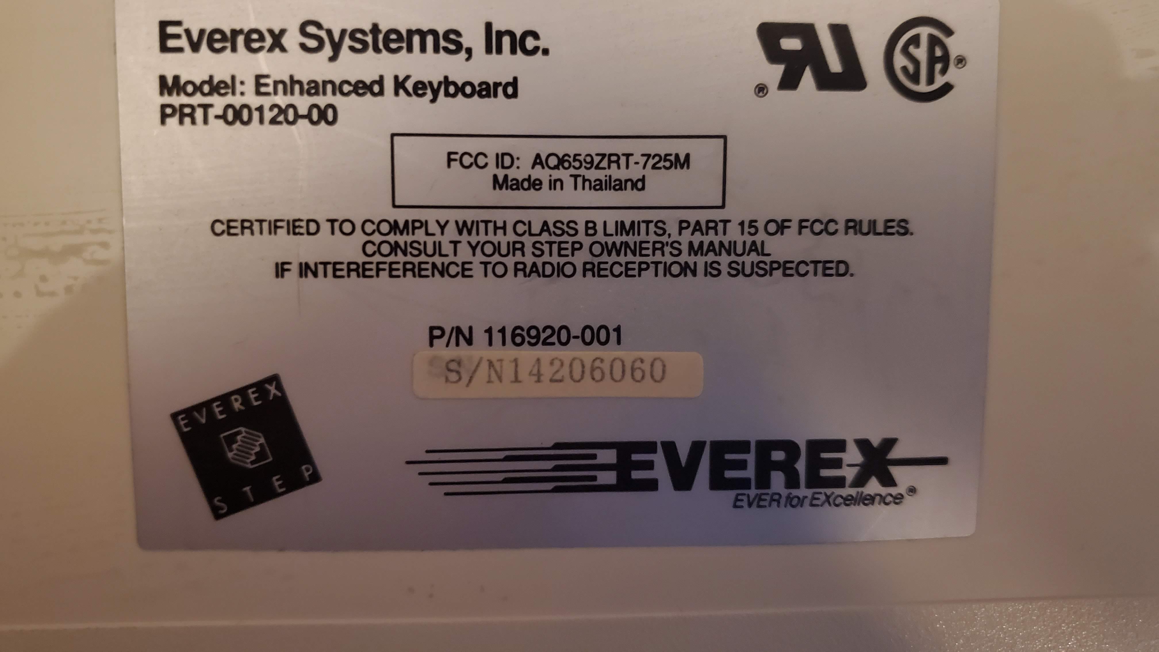

I'm waiting out the coronavirus with my family at my wife's childhood home, and I found an old Everex Step keyboard covered in crud under a bed.  It cleaned up very nicely with isopropyl alcohol and compressed air. I've taken the keycaps off for cleaning but otherwise have not opened up the keyboard yet.
242205-0 242207-1
I got a AT DIN5-to-PS2 adapter and plugged the keyboard into a computer. Lights work, keys work - mostly.  Some are totally reliable (A, for example) but others are intermittent. For example, B, C, R, and others.   I can type at a constant slow speed and moderate pressure, and sometimes the B key will register, sometimes, it will not.  Sometimes C will register, sometimes it will not.  Then I go back and type C again and it may work.
