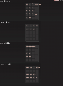

some via screenshots (working)
257892-0
257894-1
257896-2

check out the files in the zip to see what was added. again, all in the via folder, and watch merlin's video for great explanations.

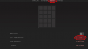

no, the via folder is not necessary, what IS necessary is the special tags in the rules.mk and the keymap to fulfill a couple preferences.
- keymap should have at least 4 layers
- needed in rules.mk
Code: [Select]
VIA_ENABLE = yes
LTO_ENABLE = yes
this can be done in the keymap folder, separate from the keyboards main rules.mk file.
also the .json file was not correct. and this is probably the trickiest part of via support.
- the json tells via how the matrix is wired (the numbers in top left of the KLE are row,column) as well as what size position the keys are at (the visual layout)
257928-0
you will need to load the json definition every time you open via because this board is not in the main repository yet.
feel free to ask any other questions on how it's done
definitely take some time to watch merlin's explanations too
also, the via firmware will function as normal even without using via.
via is just a way to change the keymap or change other settings without reflashing.
