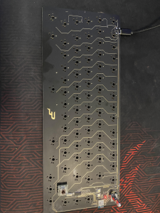

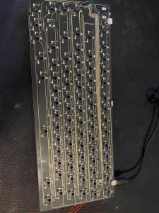

Hi Everyone,
Long time lurker here, i love this forum and all the eye candy here -  i have a bit of an issue...
So decided to do something stupid when Covid lockdown hit and decided to design and build a 75% keyboard from scratch...
I figured the build would be around the same price with a Aluminium machined case ( which is about the price of a Rama M80 or Satisfaction 75 on mech market ). And i would have all the functions i personally want :)
So i proceeded to reach out to freelancer and hired a guy to design a PCB with ill the functions i want.
Encoder knob (EC11E18244A5)
75%
Bluetooth 5.0 (BMD-340-AR)
2 X USB C hub
Gold exposed tracks etc
Got this designed, looks sweet ( pics attached ) sent to a PCB manufacturer in China, got all the BOM parts bought and assembled.250270-0250268-1
Just got this last month in Canada, plugged it in.... then BOOM realized i need firmware! LOL
So i spend the last little while looking around and trying to figure this out
I look at Zadig, QMK and Easy AVR but to be honest im in over my head - the board lights up when plugged in but i cant seem to flash / push anything to it.
If someone could assist with this, i would be more than happy to compensate you for your time and results. And upon completion give you a PCB as well ( i made 3 from the sample run)
Thanks
