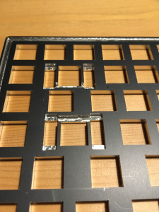

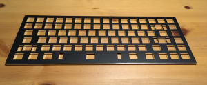

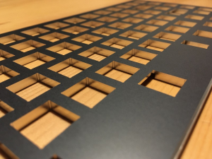

Here are some photos of the front plate, also showing the pockets which were milled to allow for clearance around the stabs and stab wires
253652-0
253654-1
253658-2
Because of the plate's thickness the switches are only held in place by friction (apart from being soldered to the PCB, of course), but when dry-fitting some switches for a test it showed that they sit in there quite securely, yet are easy enough to pull out without needing tools, in case I ever want or need to replace them.

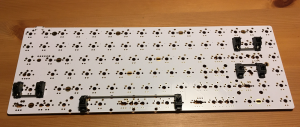

The first action was mounting the stabs to the PCB. I used GMK screw-in type stabs which came with nylon washers. It's not that you absolutely need the washers (at least for the layout I am going to use), but I used them anyways, just to be on the safe side.
I didn't do any clipping, lubing, band-aiding etc., so just mounted them factory-default.
253656-3
Next up is soldering...
