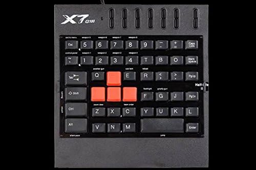

Hi folks,
I played the last years with this gamepad:
https://images-na.ssl-images-amazon.com/images/I/41Q4j2c0VML._AC_.jpg
Unfortunately it can not be bought in Europe anymore AND it is outdated in times of mechanical switches.
So I decided to build one my own.
I read tutorials, watched youtubevideos.. BUT I think I am not talented enough. I upset myself too much.
So I decided to ask guys on Fiverr, but here is the problem I am not sure if they really can help me in a way the finished product will function in the way I want it.
So I am looking for help.
Is here somebody that can design a pcb with my needs?
Of course I will pay for the work. The only thing I want is that the one helping me know what he does.

Thx for all the informations. :)
That was my third idea (build case first, build pcb first, find a ready to buy product). So I looked around the internet and found a lot of nice boards. I also found one that nearly fits my needs...
The problem I have with these splitkeyboards is that there are some gamepads to buy with layouts similar to these or similar to "normal" keyboards.
I want exactly one layout of wasd and the "bigger keys" to their left.
But I found a solution now:
I build a sandwich case with KLE and swillkb' plate builder and handwire the whole thing.
If that works fine I will try to build the pcb myself... or I find somebody here. :)
