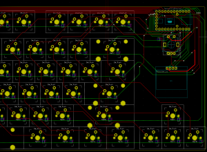

Hello, I designed my PCB for the first time. There was no problem with debug, but I'd like to ask for your advice to see if there's any other problem. I don't usually use English, so I use a translator. I'd appreciate it if you could understand even if it's inconvenient.
This is my first time on this website and I'm posting this. I'm sorry if I made a mistake. I will do my best. ;D

if schematic is ok and DRC is passing then it probably would work (assuming that design rules are defined according to factory capabilities) but there is definitely a room for improvement:
- you should use filled zones for GND
- routing is chaotic, I highlighted two examples but there is more:
265664-0

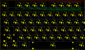

- instead of squeezing so many traces on top I would probably route them between first and second key row where is more space, maybe something like this:
265666-1
- maybe there is a way to reassign row/columns to teensy to make routing easier - I usually start with routing key matrix traces close to IC and then I figure out how to assign them

Not sure what's going on that capacitor or resistor your have on the ground trace for the OLED and encoder? In a design like this, neither need any pull up resistors or anything.

« Reply #3 on: Thu, 08 April 2021, 05:52:46 »
 :)) Thank you. I rerouted it to reflect your opinion.
