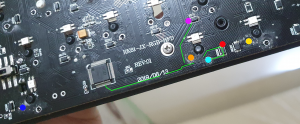

Please post a pic with the shine (seen on the edge of the PCB in the first pic) showing some traces in the affected area, I will then add some dots to hopefully help find a fix :)

Looking at the new pics all the diodes are connected to the bottom/right pins and the diodes connect up the columns which hopefully means the top/left pins connect across the row, you're not missing alternate keys so hopefully it is the whole row.  That means if you bridge the left pin of one of the switches on the left of the spacebar to the right pin on a 'dead' switch (or as they have no solder the pad around the pin) it should type the 'dead' key.  Or with dots:
269387-0
Bridge blue (you probably need to go to the next switch over as space doesn't work but you get the idea) to cyan and it should type Alt (I assume).  I'm not entirely sure what's going on below the orange dot - could just be some loose solder on the surface or could be damage.  I think all the green traces should be connected so if blue->cyan doesn't work try blue->magenta and that should type Alt.  If blue->magenta works but blue->cyan doesn't solder a bridge between red and magenta, then blue->cyan should work.  If it does solder between blue and orange and the switch should work as normal.
The trace going down and left under the orange dot looks to go back to the controller chip so if there is damage there you could have a problem - if that connection is supposed to be grounding the keys on the other side that could explain their ... actually I'm still not sure if these keys are working (continuously pressed when held) or if they are click-unclick-click-unclick-ing.  Try and clean up that area and check for damage, you might need to scrape the trace as I don't think you want to try soldering to the controller pin (a member sent their board off to a professional PCB repair place and they wouldn't even do it!  Somehow he did it himself out of desperation so it's not impossible, but easier to scrape the trace as you can see it)

No problem, this is weird to talk about and I do it all the time which is why I puts dots on pictures.  Sounds like the switches ground through you (and a very large pair of tweezers!)
You haven't lost enough keys to have damaged the controller chip so I'm sure it's all fixable, the right pin of C is probably disconnected from it's diode as it's one key in the middle and you can go up to the diode for F if necessary to test.  Left pin of right alt to right pin of B should type a stuck space (known thanks to the linked LEDs) and once the bottom row is reconnected it should unstick.  Hopefully there is no damage under orange and you don't need to scrape the trace, a cleaned up pic should confirm.
