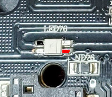

i had hoped to recognize the LEDs as WS2812 and so would have been able to tell you what to short but it does not look like any form of them i know of you could try and see if you have 5V across what should be the power pins on a WS2812B i marked red and black (should work on any of the LEDs on the board, when the board is powered)
if you get 5V across it likely mean it is a WS2812 so shorting the 2 other pins should bypass it and let the other LEDs work, and replacing it should be possible.
edit: should add the datasheet i used: https://www.digikey.com/en/datasheets/parallaxinc/parallax-inc-28085-ws2812b-rgb-led-datasheet

There are vias in lines that would connect the same pin of most of the LEDs in the closeup and I found a review video showing an instant change of colour across the board so I'm pretty sure these are conventional LEDs with a pin for R G B and 5v, can't be sure of which is which though.
Edit:I am not an LED expert, yui's experience of WS2812's is different to mine so invalidates my thoughts.
« Last Edit: Mon, 05 July 2021, 12:18:31 by suicidal_orange »

what led me to think about addressable is the pink flicker when all others are off and that part of board does not light up, it would align with a dead chip in the string that chip displaying garbage and stopping communication with the ones down the line.
but never saw them in that particular form factor and i do not know if the GMMK has individual LED control (if not addressable makes no sense whatsoever)
and if it would be RGB with common positive i would guess the 5V would be the silk-screened + in the bottom-right corner of all of them.
(and i thought the WS series waited for the end of transmission to change the entire string at once but i may be wrong, looked at them maybe 4 to 5 years ago)
