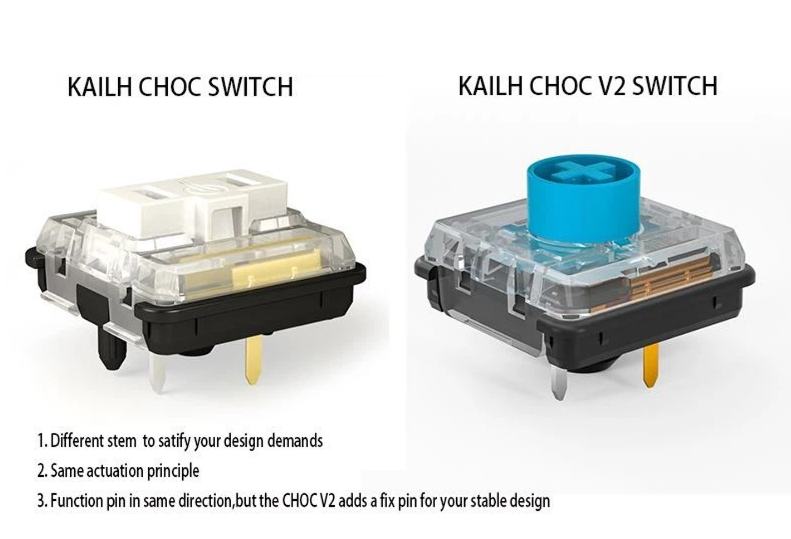

« Reply #13 on: Tue, 05 December 2023, 19:24:55 »
The MX-style stem on Kailh Choc V2 switches might make them more stable than the original.

« Reply #14 on: Wed, 06 December 2023, 18:45:42 »
Hi Dvorcol, thanks for your enthusiasm and support!
If you would like to be one of the people doing early testing, you can sign up for that on the website (no guarantees though, it might matter a bit where you live. Do mention 'Dvorcol')
About the keys: indeed, I hadn't fully investigated the Kailh Low profile v2 and the Cherry Low profile, tnx for the link. I also found a good teardown of the Kailh v2 (https://keycapsss.com/switchestester/switches/125/kailh-low-profile-choc-v2-switches).  The conceptual differences seem very minimal. Kailh has the spring around a pin on the stem, while Cherry has the spring around a pin on the base. This could matter. Kailh uses a 'torsion spring' (why?). Both have sockets for hot-swapping (Kailh is actually providing pcb-sockets for the MX). What is the real difference? I guess general product quality (production quality) may make a difference then if anything.
And for both: I couldn't find 20gr keys out of the box.

As a late response to Dvorcol's comments about the Kailh Low Profile V2 key: after some testing I can only say that he was correct.
The V2 with the Cherry interface has less play than the V1. However still more than the Cherry Low Profile (see attached movies).
Second main parameter is the friction of the material. Here we saw that the Kailh V2 had high friction. Actually all 'heavy' Kailh keys we measured had high friction.
The 'light' Kailh LP keys (35gr) had low friction, similar to the Cherry LP. Cherry's were lubed out of the box, which diffuses the ranking a bit.
How much difference does it exactly make? (Is this always the case with new Cherry's?)
Likely we will switch to Cherry, though pity they are a bit heavier. Does anybody know how to acquire Cherry LP springs?
