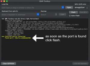

this might help catch it, it's the way i do it. (copy/pasted from my response on another thread)
- promicros can be tricky to flash, even with resetting twice in a row you only get 8 seconds to catch the bootloader
so, - edit & download the firmware
- open QMK toolbox and get it ready, select the correct firmware
- reset it twice quickly
- as soon as you see the port open up in the window, click flash.

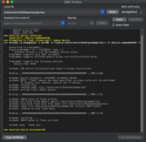

- wait for the confirmation message that flashing was successful
270787-1
