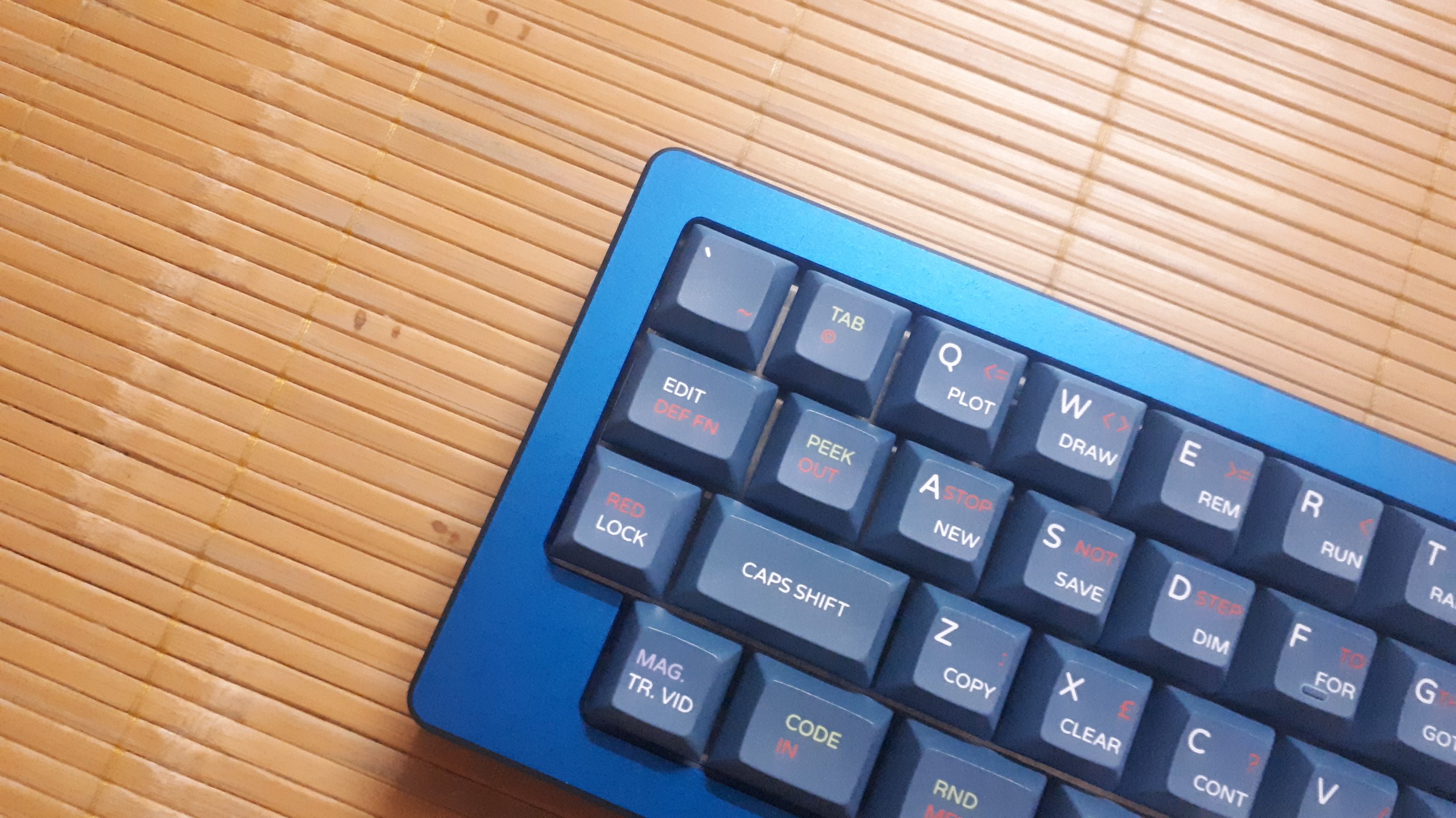

More pictures of the prototype: https://imgur.com/a/cVOz7Ni

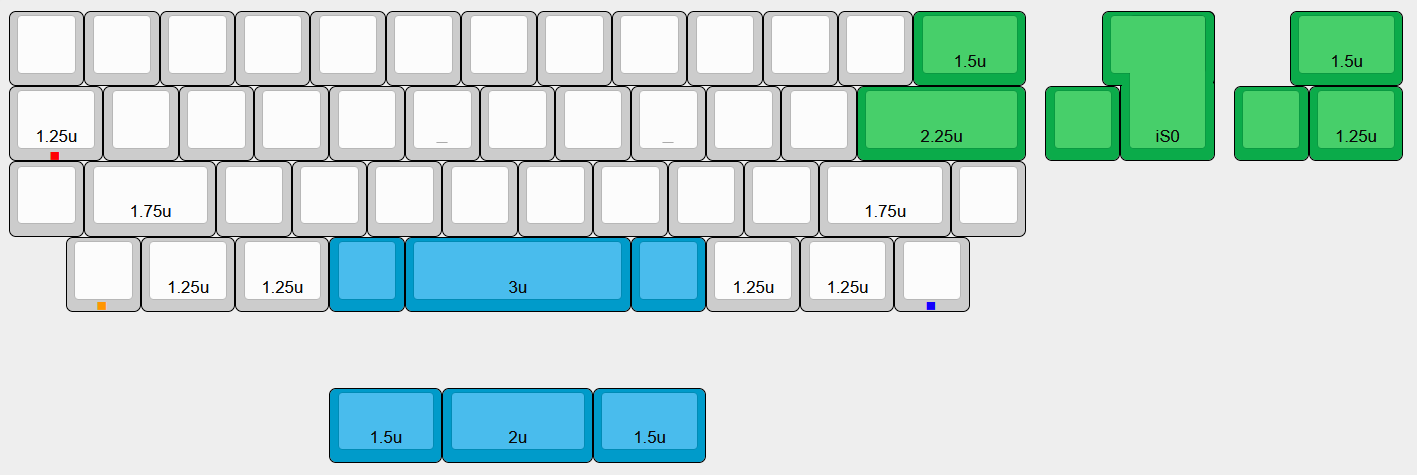

my layout is inspired from this design
272901-1
of course I have to adapt this to qwerty layout.

the board is powered with ATMega32u4, which is QMK/VIA compatible.
as you can see in the album, this board actually use 2 PCBs (controller-PCB and key-PCB), I know this might be unnecessarily complicated but I can't find other way to put all the components on small PCB (I can't hand-solder smaller components)
- Case
The case is CNC anodized Aluminum.
My current design is two-pieces top-mount case, I plan to change it to one-piece tray-mount case.

I like the idea, the layout seems qwerky to use but I am sure that it has some learning curve to it.
I would however refrain from using a 3U spacebar. Those are hard to come by, both in keysets and in stabilizers because the wires needed are not easily obtainable.
you're right, weird layout may turn buyers away, so after some feedbacks, I decided to change the layout:
273310-0
(I still want to keep the symmetrical look)
I think this will help with the sale.
I also change the case design to tray-mount, the case has typing-angle of 5°, also one-piece case would keep the price low.  :D
I will order new prototype soon.
after I receive the prototype and finish the new build, I will post a formal interest check.
Don't gauge ideas by how buyers will receive them. Imprint your persona into your projects, and people will resonate to that
