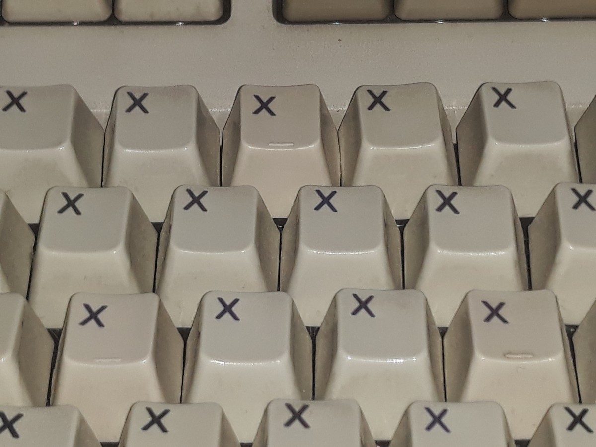

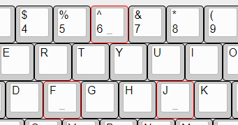

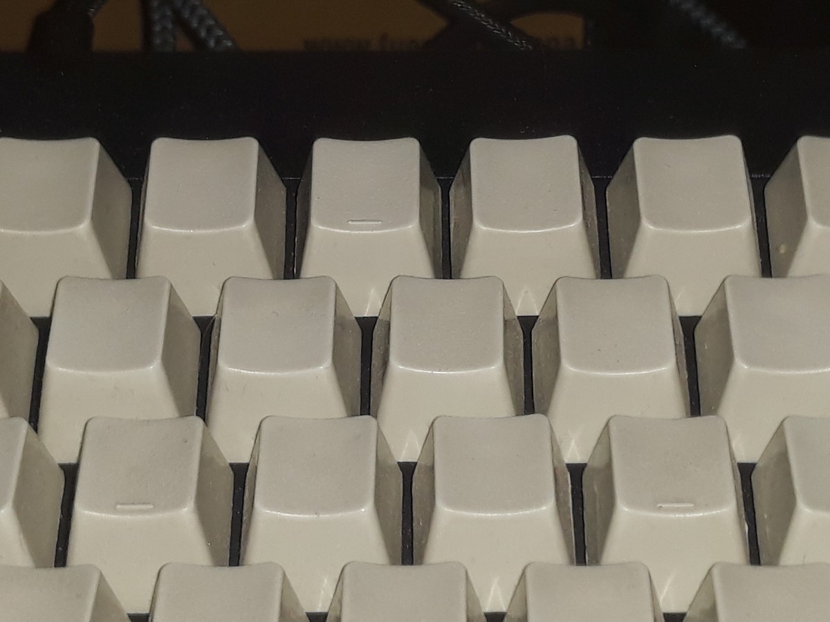

I thought that could this be solved by placing a homing bar in one key in the num row itself, to allow the fingertips to find the correct position just by moving the hands a bit to the left or to the right. I juggled the different possibilities, and this is what I came up with:
288278-1
288280-2
In principle, there's a case to be made for any of the keys 4 through 8:
  • 4 and 7 correspond to the same columns to F and J, respectively.
  • 5 and 8 are closer in vertical alignment to F and J, respectively.
  • 6 looks balanced(-ish) and is actually a natural limit (think of split keyboards, where 6 is the rightmost key in the left half and 7 is the leftmost in the right half).
I experimented a bit and quickly found that 6 seems to be the best option — the homing keys F and J serve as positioners ("place the index here before starting to type"), but a homing key 6 functions as a limit marker ("don't go any further" for the left finger; "go back to your area" for the right one... or the other way around), which makes more sense for the number row.
I'm quite happy with the results, and plan to keep those two keyboards this way. Heck, if it were for me, this additional homing key would become part of the standard.
