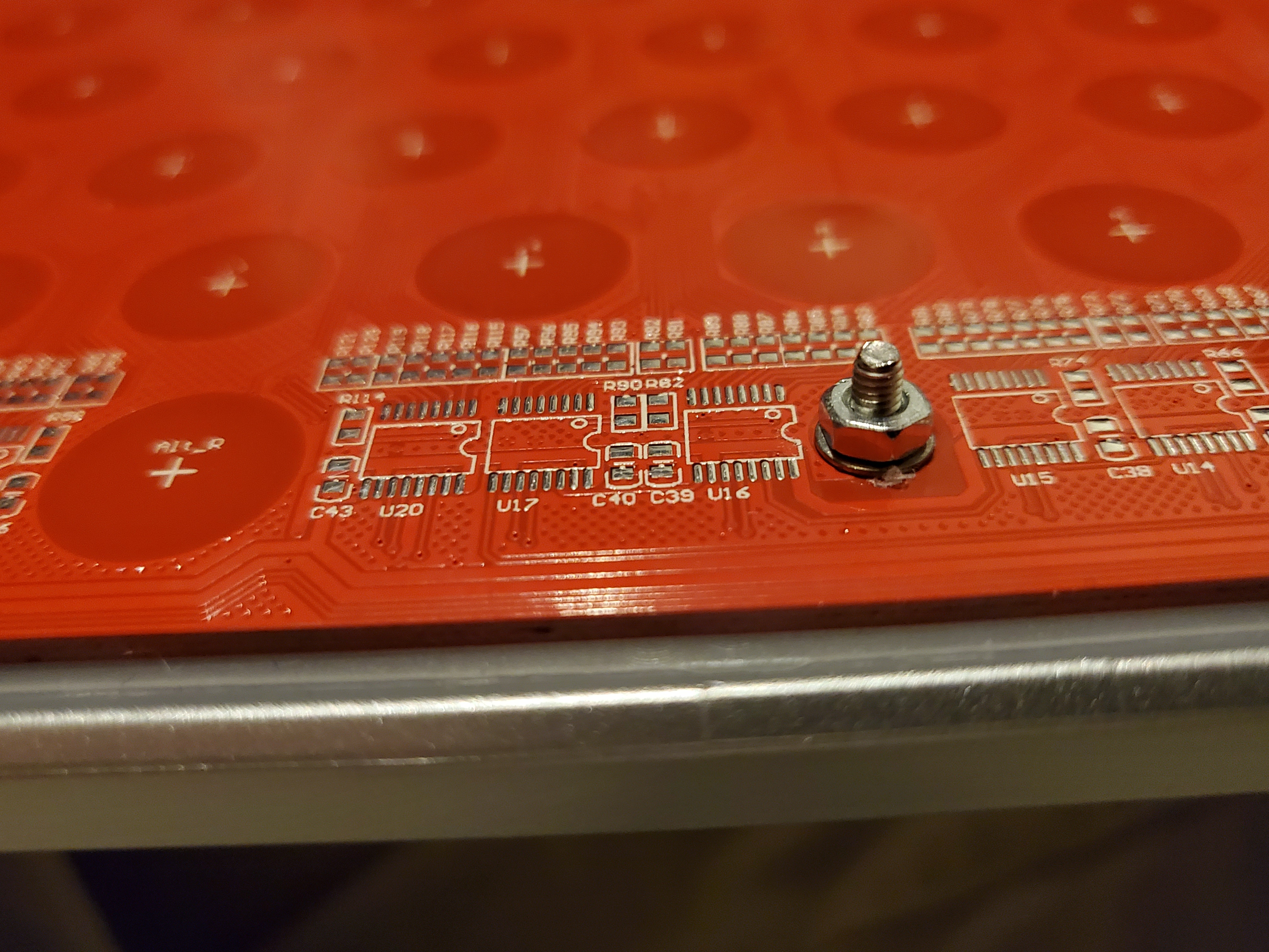

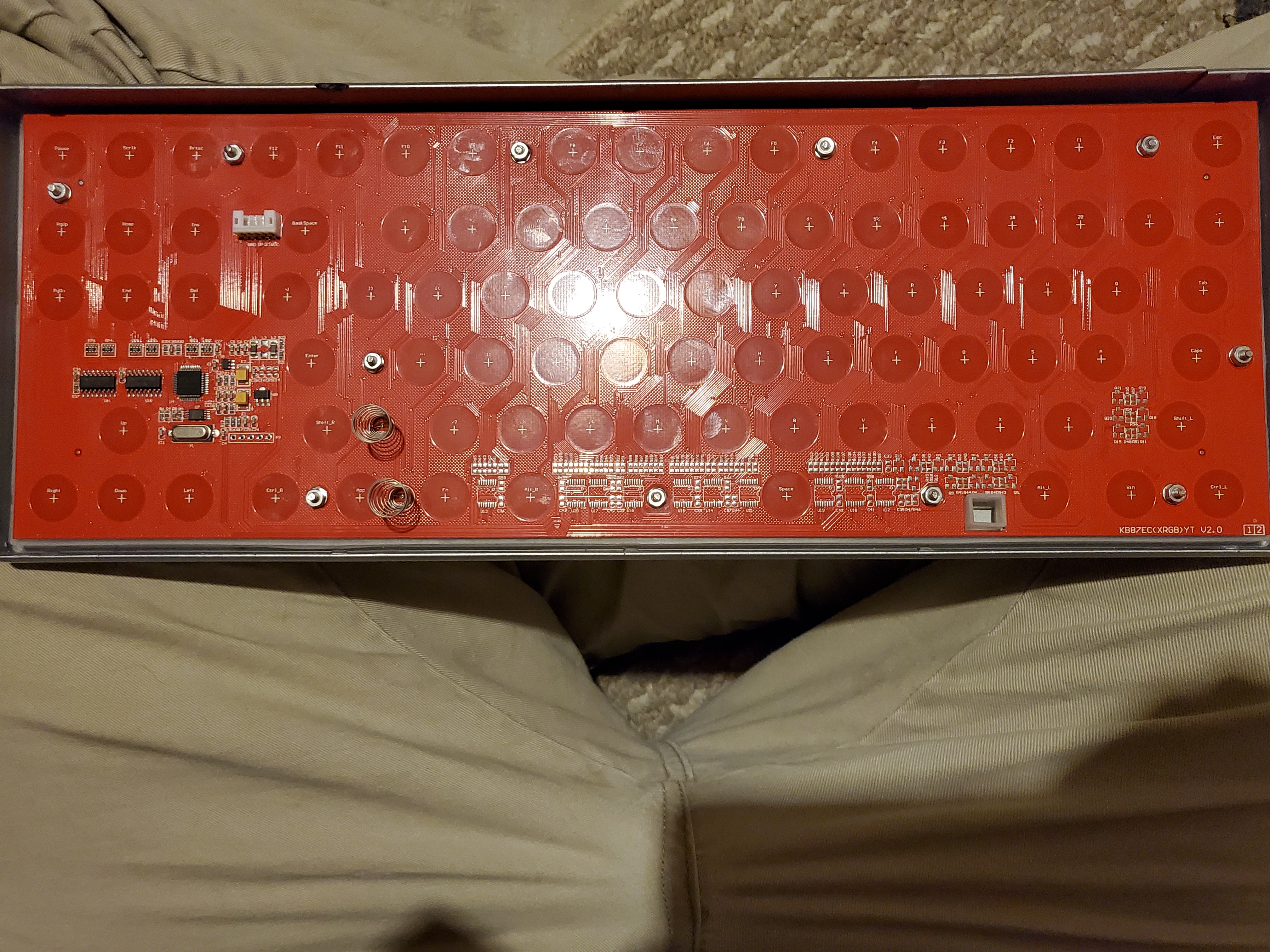

My solution was to drill out the old plastic posts straight through the case so that I could replace them entirely with screws, nuts and washers. I chose to use the following:
M2.5x12mm machine screws (it turns out even standard pan head screws do not obstruct the caps on the downstroke)
M2.5 hex nuts
M2.5 washers
278074-0
278076-1
278078-2

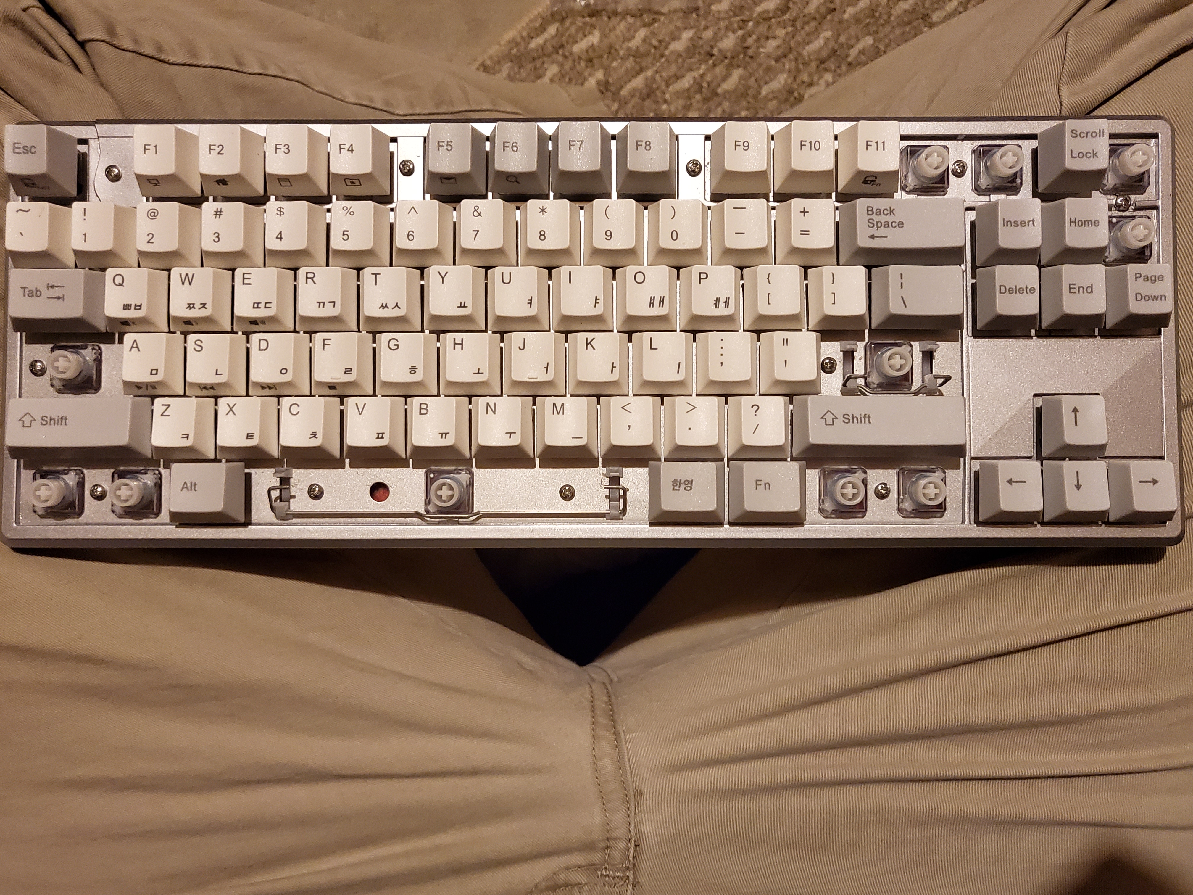

Wherever the screw head intersected a thin raised portion of plastic, that plastic was broken or cut off, as the edge of the cap above also usually hovered above as well. With the top row of keys, I had to put significantly more time and effort into drilling through the case. I think there's actually some metal reinforcement in that area, between layers of plastic.
I had to take the resulting sandwich back apart a few times and tweak the tightness of the screws in order to get every key working and for it to feel as smooth as it did before the mod. If you really torque everything down, I think you end up smashing the rubber between more than it should be. I ended up settling on just holding the head of the screw in place with one finger and tightening the nut with a nut driver (5mm in this case) until it felt firm enough to not back out.
The result should, hopefully, be something a lot more durable and serviceable than the original design.
