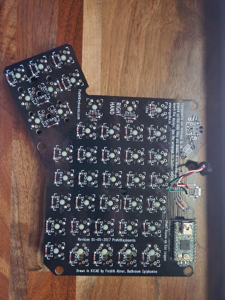

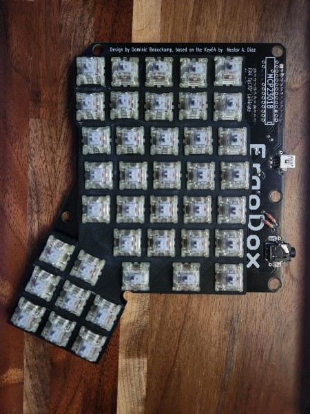

P.S. Attached are some pictures of my left hand assembly. I chose to solder the teensy on the bottom instead of flipping it. Also, I am aware there are variants that I probably should've gone with that allows for the left to be dominant, but that would've been easy, and who wants that?

I spent the past hour verifying the pinouts, and I'm pretty sure I have it right. As far as my brain is telling me, it should match the same pinouts, and all the checks I've done match properly. Data pins are where they should be, and power is correct.
And here's a new thing I just figured out. I was getting irritated and decided to plug whatever had a 3.5 mm plug on it, I started with my headphones, and it DOESNT CRASH. A unconnected 3.5mm cable will stop it dead in its tracks, but my headphones let it plug along.

Are you plugging in the 3.5mm while it's switched on, causing a short in the socket?  That's not a good idea...
Heh, soooooo, I figured it out. I wasnt plugging it in while powered up, but I WAS shorting it.
I swear I'm dumber than a bag of hammers sometimes.  :confused:
Long story short, while I was staring at the pcb files in KiCad, I realized that there are 4 pins on the 3.5mm jack... And I was using a 3pin aux cable... :-[
Basically, I've been shorting power and ground. And it was crashing the Teensy. It's a wonder I didnt fry the poor thing.
Thank you for the help! I ordered the proper cable on Amazon (small town, no 4 pole cables here) and it'll be here Tuesday. That should hopefully allow it to function properly. Lol.
