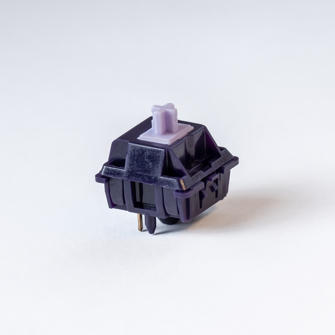

A heavier 'Ergo Clear' is of course the T1 switch. It is almost completely a top-mount switch, though. So it's not a Cherry-like bump and it is not great for pre-travel. It is worth mentioning, because it fulfills the role of a mid-weight or medium-heavy Ergo Clear for many people. Veterans of switch customization have said on a few occassions that T1-like switches are 'better Ergo Clears.'

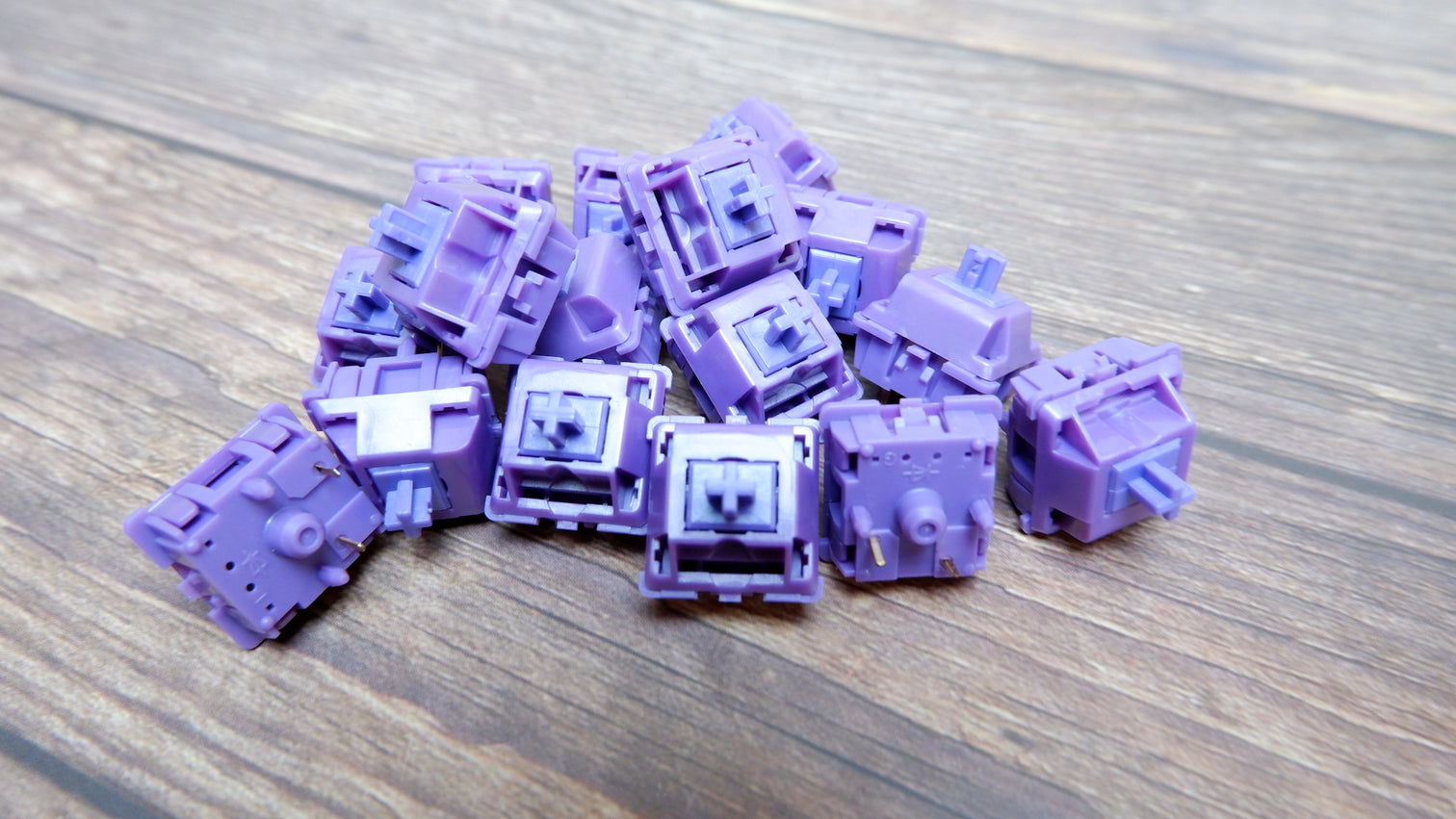

One of the nicer T1-like switches is the SP Star Polaris Purple, and I think there was a Durock 65 G T1-variant called the "Lilac tactile." Anyway, both of those are pretty decent in stock form. And you can get the super-budget version of the T1 from JWICK, as the JWICK T1 V 2.0.
There's something called the SP Star Magic Girl that may be a somewhat toned-down T1, maybe it uses a medium-tactile stem. If going for this switch, get the "Dark" variant as it has better housing acoustics.
