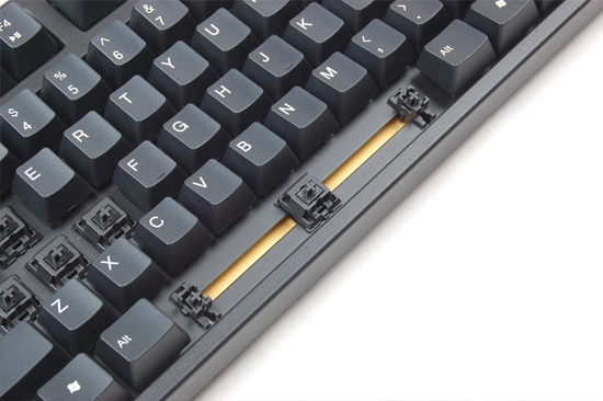

This is a screenshot of the Ducky 9008's stabilizer used.
Here is a screenshot of the Filco's costar stabilizers
Seems that the spacebar, shift and caps keys are same like Filcos (except for the stabilizer part of course)

The black (non-movable) + tabs (Ducky's method of stablising the keys) are what is dampening the feel of those keys. On the Filco, a metal bar and plastic hooks are used to stablise the key (photos of this can be found online)
I prefer the Filco's method. The feel of the keys are more consistent.

3. Ducky uses their own controller (not the same as costar). Could be a plus or minus depending on who you are :X
4. Ducky uses Cherry Stabilizers which are more sturdier and from the looks of it easier to remove, compared to Costar stabilizers that can easily break if keys are removed incorrectly.
5. roughly same price as the Filco, but if you consider points 1, 2 and 4, to me seems as if the Ducky is a good deal.
One minus i must say, yes the aesthetics for the led lights on the Ducky i prefer compared to the Filco, however since i am ordering double shot replacements, it may not be so good for the Ducky since some of the keys have lights incorporated onto the key. A Filco may have been better in that case for a cleaner look (assuming you wouldn't mind the lack of the mini usb feature :/ )
