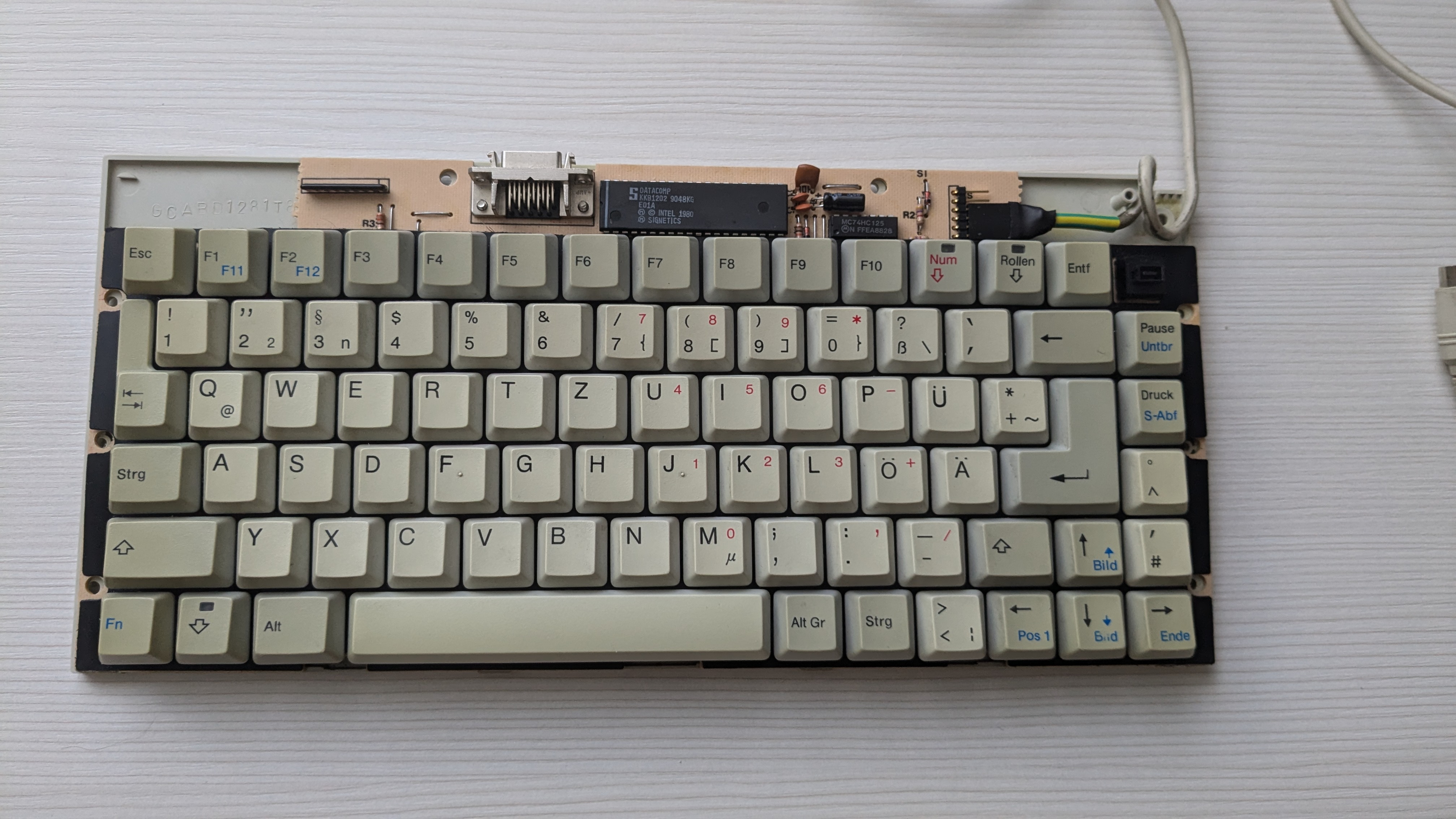

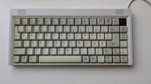

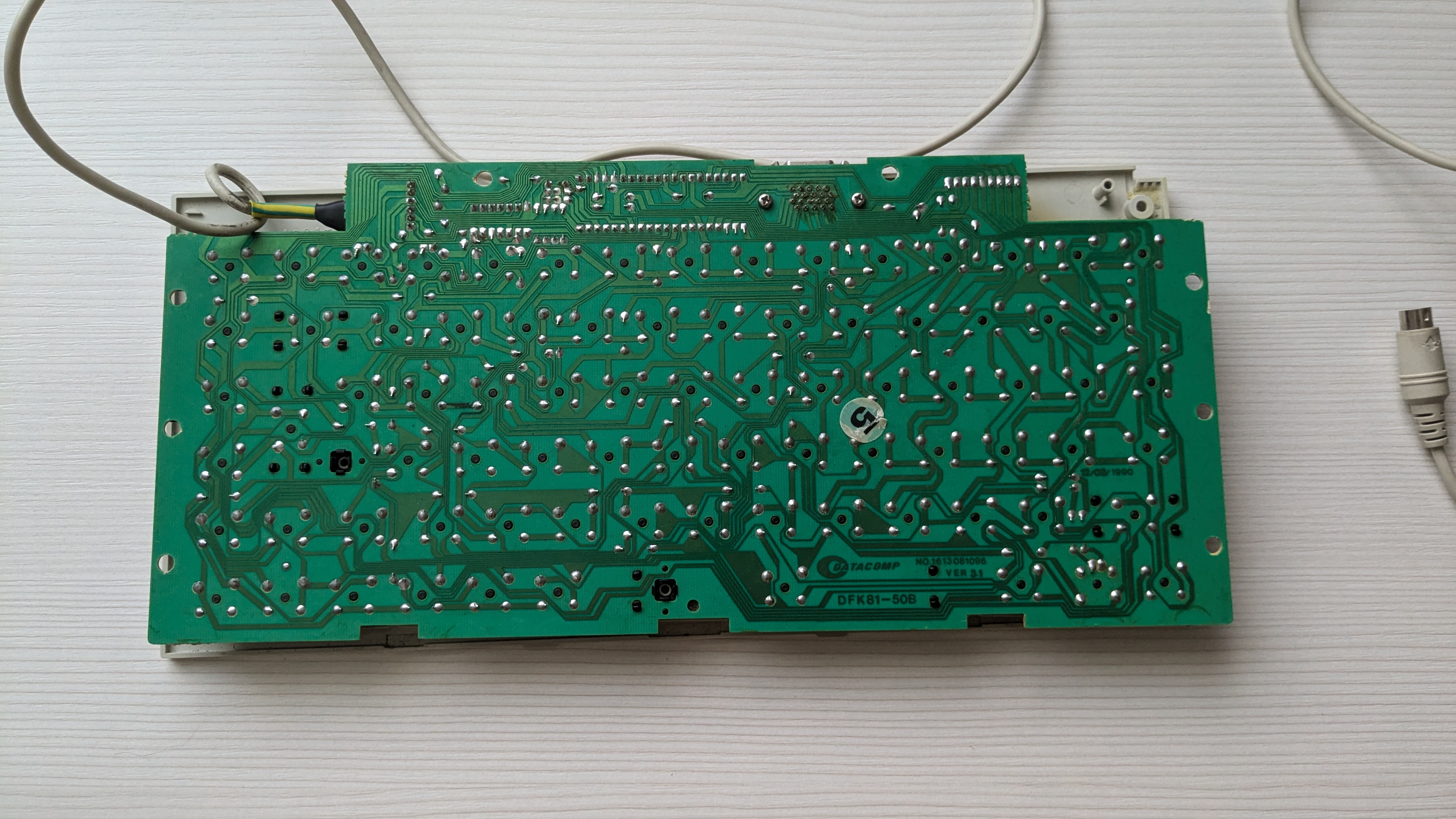

I recently bought this keyboard from a young lad for around $16. The PCB suggests that it is a Datacomp DK81-50B.
The layout can be called a 75% by today's standards. It uses Alps SKFR Black (SKFRAC) switches for most of the keys, the exceptions being NumLock, ScrollLock and CapsLock keys which use Alps SKFR Yellow (SKFRAD) switches. I didn't manage to find anything about this keyboard on the Internet (at least nothing that goes by the name Datacomp DFK81-50B).
It's in quite a rough state (noticeable yellowing, a missing keycap, the cable has been tampered with, none of the screws seem to belong to the keyboard) being around 33-34 years old. The switches feel quite scratchy and pingy which is not surprizing for a linear type of switch this old.

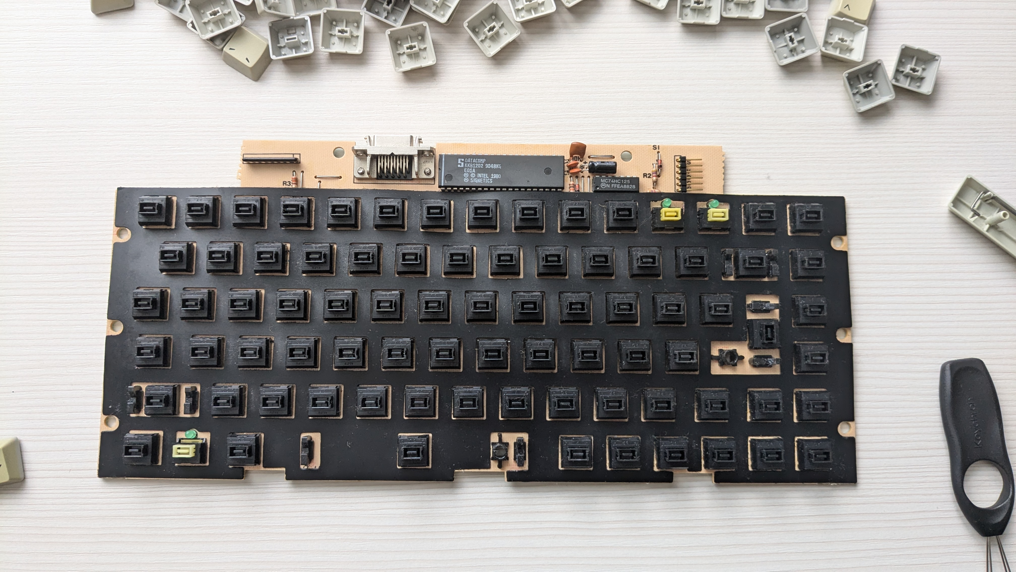

I would like to know if Alps SKFR's can be opened up without desoldering them akin to SKCM/SKCL switches (I see that they look quite different from their older brothers but there might be a possibility). There is no mounting plate so the switches are mounted directly to the PCB with some sort of a protective plastic(?) sheet that is glued to the bottom of said PCB.
The biggest problem of the keyboard is switch chatter. It affects almost all the switches. That is why I want to give the switches some proper maintenance. Some grease might make this keyboard feel and sound much better. Unfortunately I have no proper equipment to record a good sound test, though you can check out Chyrosran's typing demo of these switches.

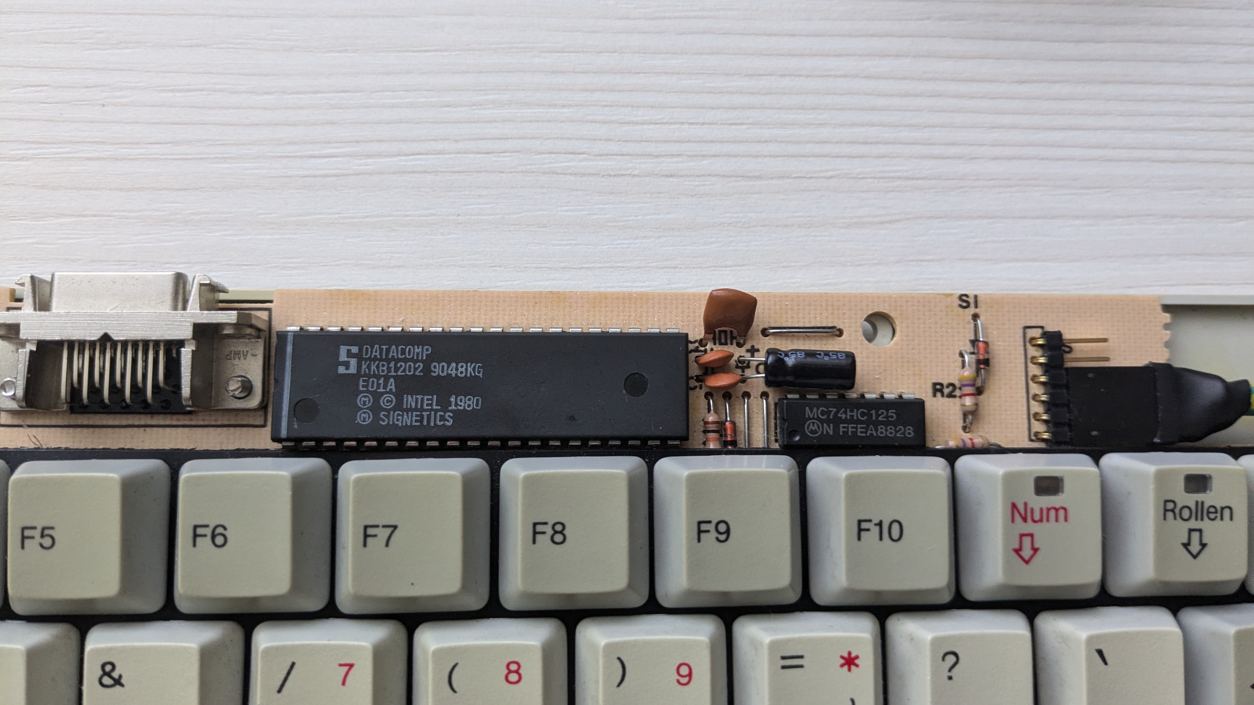

309447-1 The keyboard without its top plate    309449-2 Intel Controller
309451-3 The PCB itself
309453-4 Keycaps taken off

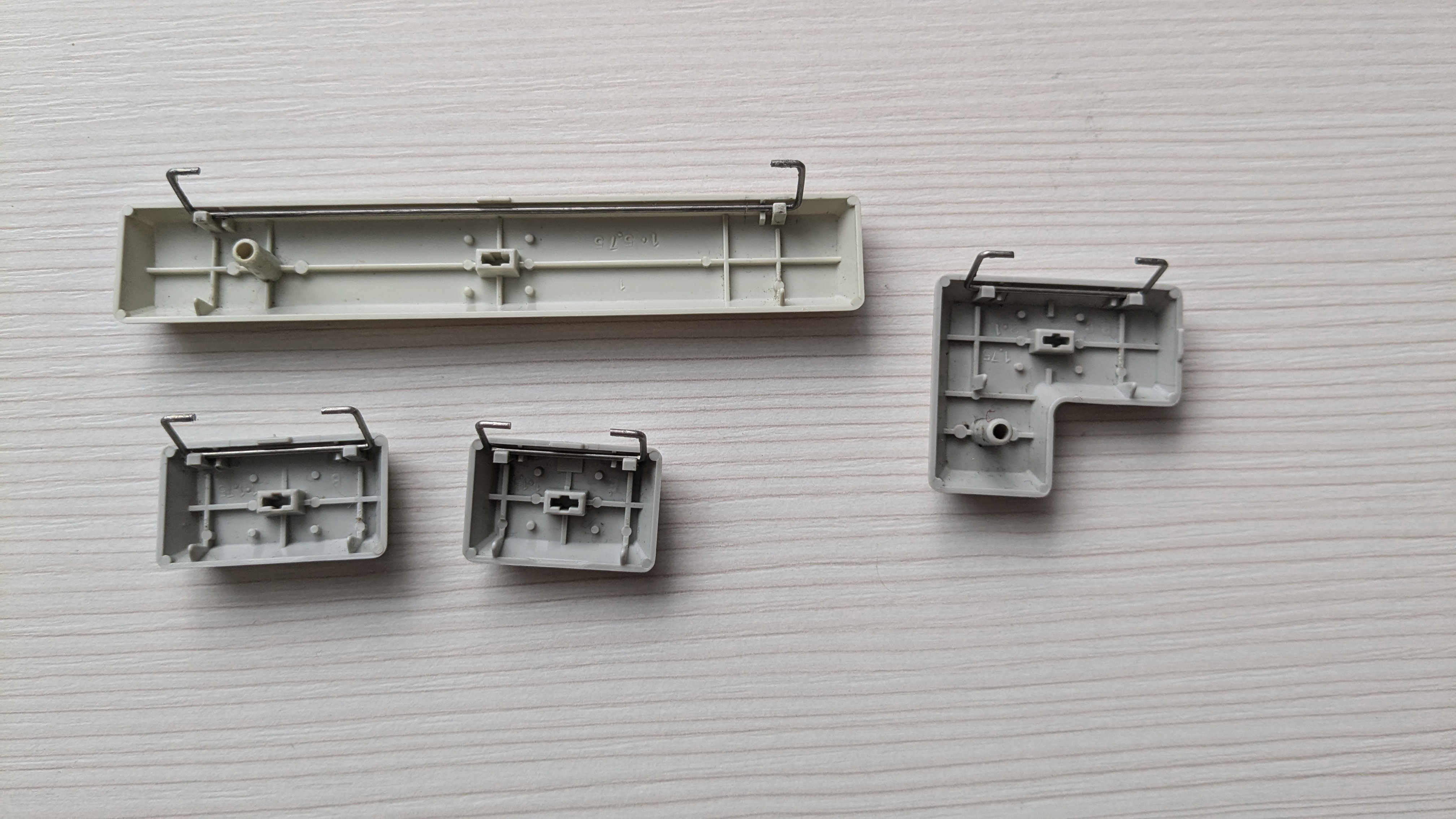

309455-5 Stabilized keys
