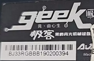

Is there a way to determine what type of switch a particular Ajazz Geek AK33 uses by reading the barcode on the back of the unit:
309488-0
Briefly, I need to replace a black switch (i.e. non-clicky) AK33 that has a defaced (hence no helpful barcode) label.
Unfortunately, the people flogging used ones (all I can find) seem to know even less about keyboards than I do.*  While I suspect I may be on the wrong track with the barcode, I am hoping there is some sort of "tell" on these keyboards that reveals what keyswitches are installed on a particular unit at a glance.

1. Some interesting layout choices on this little guy.
2. Based on this pic from the Amazon listing's reviews, you maybe on to something that the bottom label could help you, but I'm afraid it would be a lot of research to track down images and cross-reference.

I use to be an Ajazz vendor a long long time ago. Ajazz uses Huano made switches in all their pre-builts. So if an AK33 comes with say Red, Blue or Black switches, it is most likely a Huano Red, Huano Black or Huano Blue etc. Hope that helps.
