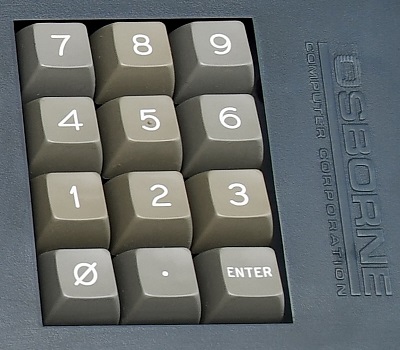

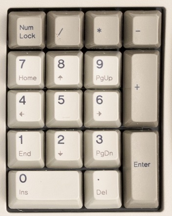

Back in the day, adding a simple 4×3 block to the right-hand side of the keyboard, to be able to comfortably type numbers, was quite the improvement.

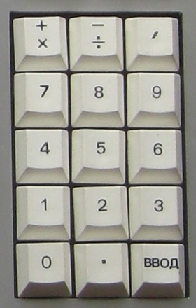

That block grew later to 4×4 or 5×3, depending on the computer system...
... and then up to 5×4, the size and shape that was fixed and codified in the Enhanced Layout; there have been no major changes in the last four decades.
The “common” 5×4 numpad has the digits 0 to 9, a period (or a comma, in some national layouts), an Enter key and the four most common symbols (the four basic math operators: +, -, * and /), as inspired by pocket calculators. And yet...

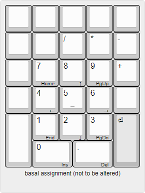

So... we need to take into account more usage cases, we need more keys, and we need to consider the position of the numpad relative to the alpha block.
Adding one row wouldn’t be enough. Adding one column wouldn’t be enough, either. Two rows or two columns would be unwieldy to operate with a single hand. Adding one row to the left and one column above (for a maximum of 30 keys) seems best. Also, four decades (and more) of users’ muscle memories constitute an unavoidable mandate to keep the basal assignments unchanged (with three exceptions, as noted). This, then, would be the starting point:
Other than the extra keys, the main differences are:
  • Numpad+ is split onto two keys.
  • The assignment of Num Lock in the top-left corner is shamelessly erased. Sure, it needs to be available in the keyboard, for compatibility, but there is simply no valid reason to maintain it in the base layer, occupying prime real state, to boot. Heck, IBM itself moved Num Lock to Shift-Scroll Lock on the SSK back in 1987, and that’s fine and dandy, and should have become the standard long ago (i.e.: 1987).
  • Numpad0 is shrunk to 1.5U, while numpad-period grows to cover its space. Given the importance of the number zero, it was important to avoid shrinking its key to 1U, but keeping it 2U wide complicates things for left-side numpads. Making both keys the same width, as was done in some old terminal keyboards, is best. It’s for the same reason that the bottom-left key is 2U tall, to mirror the numpad-Enter key.
Note that splitting the 2U keys, or joining up the two 1U keys above them into single 2U keys is not unfeasible — on IBM Model F/M keyboards this is trivial, while on modern custom keyboards, PCB makers know well how to make “holes” for both possibilities.

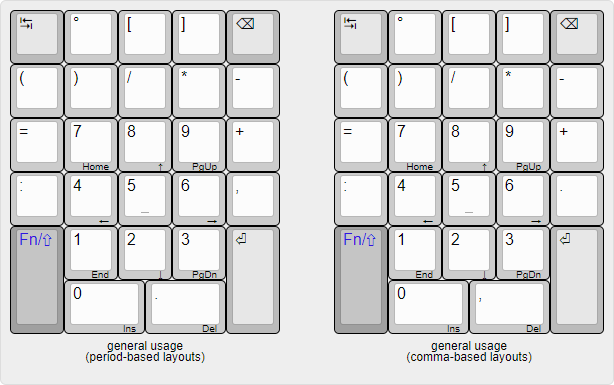

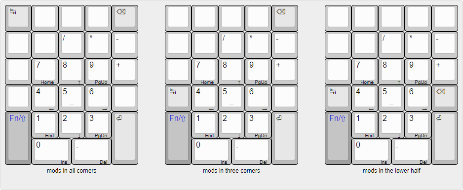

We should start with the modifiers. The bottom-left 2U key should be an Fn key (doubling as Shift on some keys, to be seen later on). Tab and Backspace naturally fall on to the top-left and top-right corners... although there is something to be said about the convenience of moving them to the lower half of the numpad, if their expected usage frequency should be high enough (after all, the hand should be mostly on rows 3 to 6, move up to row 2 with less frequency, and all the way up to row 1 occasionally).
290873-5

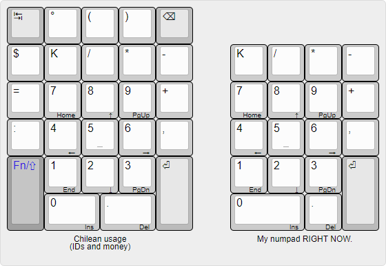

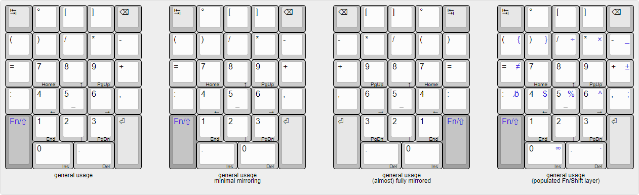

Although each and every user will have his/her/its/their own preference, let’s go for now with a “mods on corners” scheme. With the basal assignments and modifiers already in place, we should place the needed and welcome additions. Let’s start with a numpad intended for general usage.
Besides the already mentioned comma and equal signs, the colon sign, parentheses and the degree sign (the only non-ASCII character... so far) all come naturally to mind as often-required.
The English (en-US and en-UK, among others) layouts use a numpad-period key, while many other layouts (German and many of its derivations, Portuguese (Brazil), etc.) opt for a numpad-comma key. Placing the comma above the Enter key on the former group and flipping both on the latter both preserves compatibility with the extant national layouts and allows both to be comfortably used, as both signs are, indeed, frequently used. Note the placement of the colon, also a frequently used symbol when mixed in with numbers; its usage on time markers is, by itself and even if all other usages were to be discarded, enough to merit its placement in one the keys closest to the digits.
The symmetrical nature of this numpad allows for easily mirrored versions.

Some people like their numpad fully mirrored, some partially, some not at all. In my personal experience using a left-side numpad, I’ve found that swapping only the numpad0 and numpad-period (or numpad-comma, as the national layout may dictate) keys works best for me.
The Fn/Shift key can be used to access a few extra symbols that are not as frequently used but are nevertheless convenient to have on the numpad.

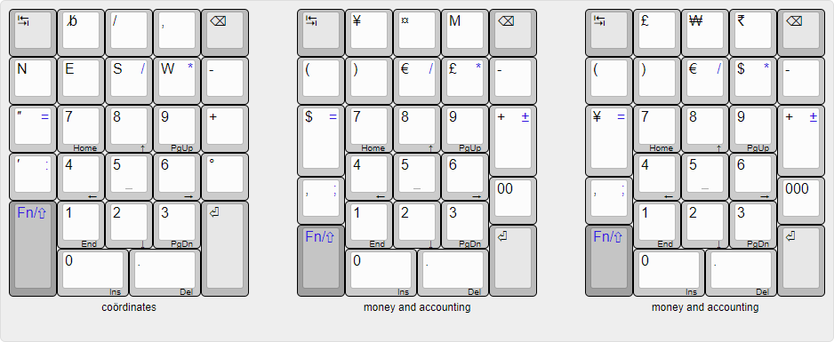

But this, so far, is for general usage. How about some specialized usage cases?

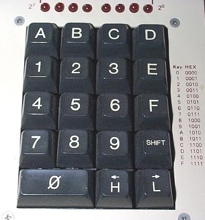

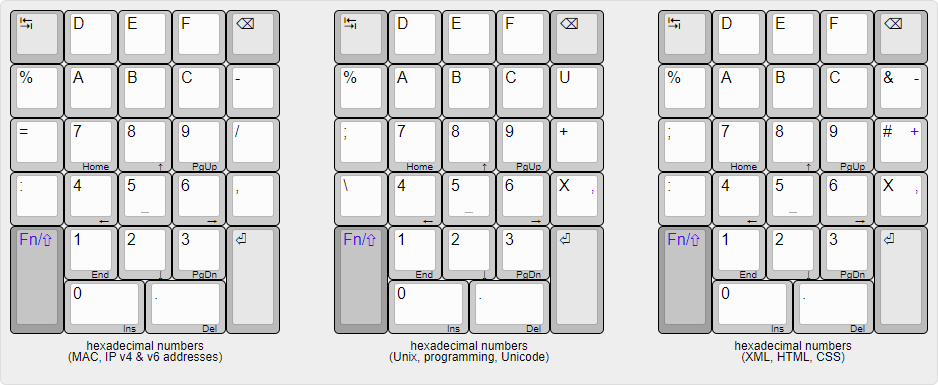

Hexadecimal numbers have been around for quite long in our industry, and yet they have barely been subject to proper input mechanisms. A couple “hexapads” in old keyboards are known, arranged in a 4×4 key block:
... but this would clash with the muscle memory of modern users. In not few cases, the numbers A to F were shoehorned into a 5×4 cluster, resulting in a rather inelegant arrangement:
It’s just best to take advantage of the sixth row and keep the logical progression. But then, the associated typographical symbols (and letters) vary wildly from computing context to computing context, to the point that we can easily design three different (modern) hexapads for distinct sets of needs:
290882-10
Note how here referring to the bottom-left key as Fn/Shift pays off: thinking of it as Fn allows dissasociating numbers from symbols for the “additional characters” layer, but it’s best to think of it as Shift when dealing with letters, as most of the time they will be wanted as lowercase, but sometimes in uppercase (contrast, say, "\u00f3" with "U+00F3").
Other specialized usages can be easily thought of.
290884-11
It's easy to see people who type coördinates a lot clamoring for a numpad like the above (or, more probably, calling it a decent enough starting point and then piling on adjustment requests). People in financial institutions might get a kick out of the two financial-oriented designs above (note the hardware variation, where two alphas have been enlarged to 1.5U in height).
