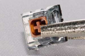

Closed-Box style stems (like on Kailh Box switches) seem to add a protective wall around the stem.
This design significantly reduces the gap you get on the classic design when the key is pressed.
Kailh Box Brown V2 with the stem pressed down:
317070-1
Same goes for closed-cylinder style stems (Gateron, Kailh) and other closed shapes.

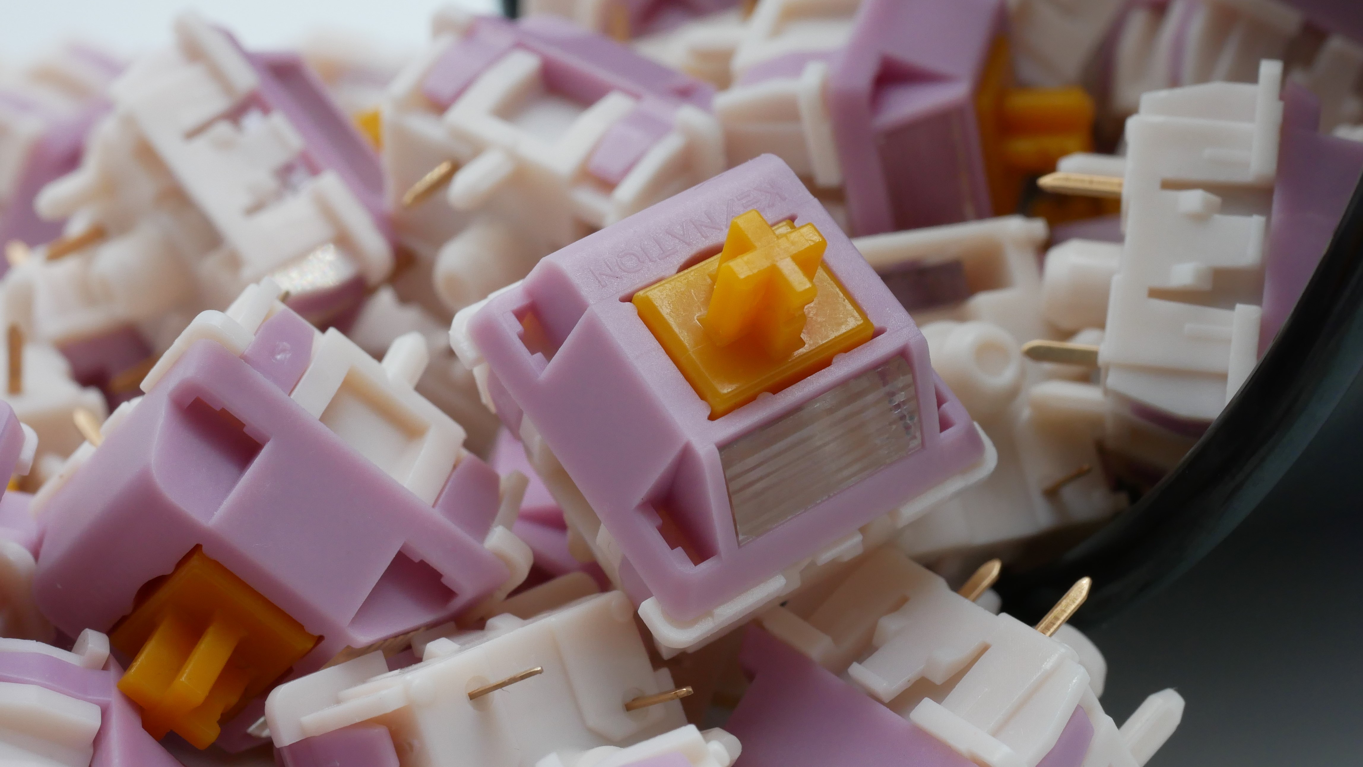

Notched Box designs (AKKO, BSUN, OUTEMU, JWICK, TTC...) are (in theory) somewhere in between.

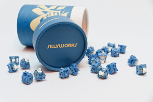

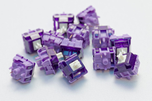

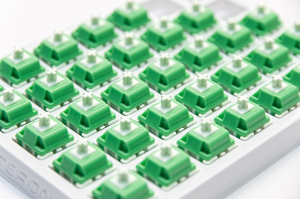

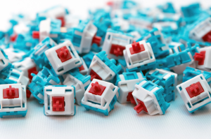

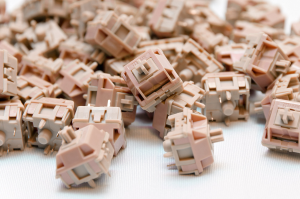

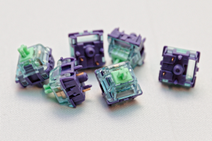

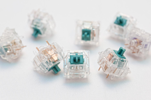

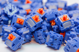

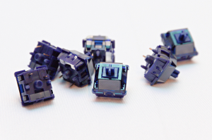

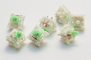

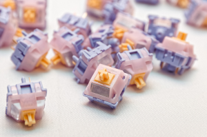

I used key-switches from major manufacturers (Cherry, Kailh, Gateron...)
The Switches were chosen to represent a range of stem types and housing designs.
317072-2 317074-3

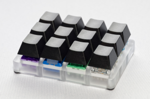

Prior to contamination, all switches were tested (in stock condition).
Multiple identical units of each model were used to enable statistical replication.
Each switch was mounted on a switch tester and actuated many times.
Actuation feel was documented (smoothness/scratchiness/stickiness).

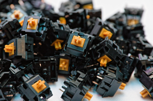

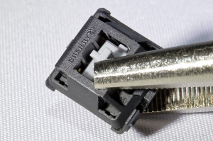

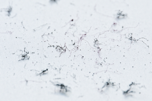

I felt that dust from abrasives would be best, as it's ingress into the switch would be more noticeable.
I decided to go with Scotch-Brite pads which I rubbed against each other.
This not only creates scratchy dust but also small fibers.
317076-4 317078-5
The switch tester was securely fixed at the bottom of a small sealed container.
A "precisely measured" (not) amount of the contaminant mixture was placed into the container.
The container was sealed and vigorously shaken for 30 seconds to achieve a random/even distribution.
After shaking, the container was left undisturbed for 1 minute to allow airborne particles to settle.
