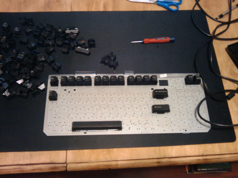

First, pop out them little clips keeping the 'board together:
Pretty easy, just a flathead screwdriver is necessary.  Make sure to do the end first, so you can keep it apart as you hit all 10 of the clips.  Starting in the middle will get you nowhere.
Here's what you end up with:
Cute little controller, huh?
Interesting, it just smashes down against the membrane contacts, and there's a rubber bumper underneath to be sure it makes tight contact.

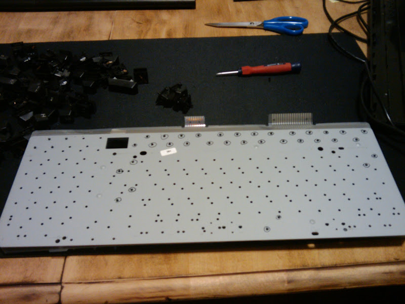

Anyways, take out the hex screws from the controller and the metal plate and lift out the metal plate:

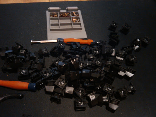

Now how do you take the switches apart?  They're open on the top, but the sliders don't fall out, so what's next?  Well, let's take a look at the back of the  metal plate.
And a bit closer:
Aha!  So give those little black clips a little smack and they pop right off!
Here's what the switches look like after you get them off:

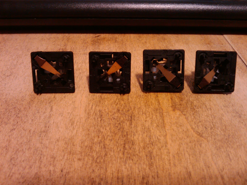

Back end of the switch:
The metal you see there is the actuator leaf, you should take that out before attempting to remove the spring.  You don't HAVE to, but it kind of gets in the way, and if you mess it up, that switch work work properly afterwards.
To remove, just put a precision flathead underneath as shown:
And shimmy it up while rotating the driver:

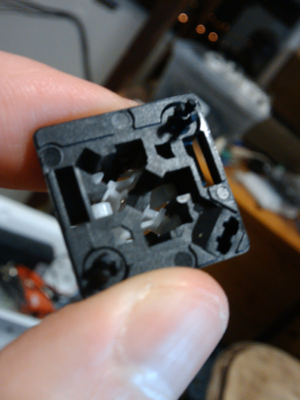

Now to the not so easy part.  Getting the slider out of the switch housing.
Even Sandy55 had trouble with this one.  Rough translation seems to imply that he just gave up and destroyed the case:
The right where I gave up the axis because I am hard to take it off very much is a photograph of the backside.
But alas, I had to make this happen and put them back on the 'board, so no switch destroying for me.
In comes plastic toothpics to save the day!
What's happening here is that there are two tabs(on the left and right) that click into place and hold the switch from coming out of the housing.  So you have to press those two tabs in toward the center of the slider while pulling it out.
Also, there are two tabs on the top and bottom that seem to be a second means for holding in the slider, but these don't seem to actually get in the way once you get the other two pressed in, they just click out of place and the slider comes out.
Unfortunately this is not easy until you've done about 20 of them, then it starts to speed up.
Basically you just insert the toothpicks from the top of the switch and confirm that they are coming out the other side(above pic is an exaggeration, they should only stick out enough to see them, otherwise you'll have trouble getting the slider to move).
It will look something like this:
Then once you've got them in place you use a blunt object to push the slider from the bottom.
Something like a larger hex driver like this:
Don't use a flathead or phillips, there's a chance you might gouge or break the internals of the switch and make it useless.
But watch out!  When then slider gets to the end of the casing, everything will go flying as all the energy from the spring and from the toothpicks will be released!

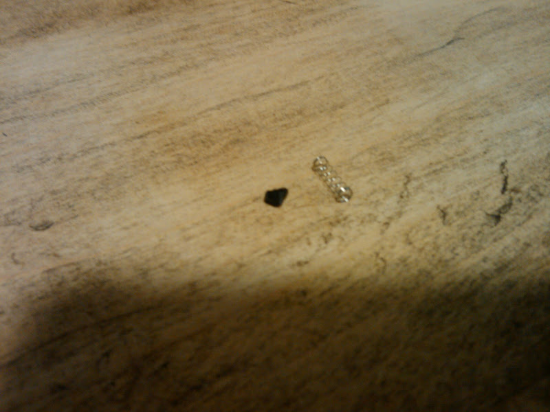

Then you just remove the spring from the slider:
Teesy little things, but so much force!
So you remove the spring, take the slider and put it back into the housing.  The slider goes in only one direction, there is a corner that is larger than the rest, it goes on the corner opposite to that big lump of plastic on the housing:

Re-insert the actuator leaf and you're done!
Then to get the switch back on the 'board, just put it in place on the metal plate, then push down on each corner(with a screwdriver or something) that has a tab one at a time until it pops back into the plate.

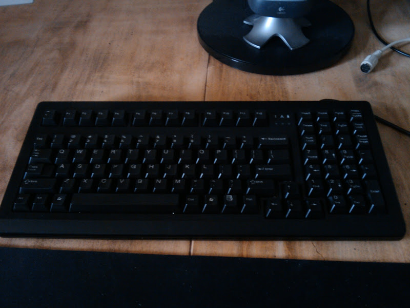

There, doesn't she look better now?  Wait...

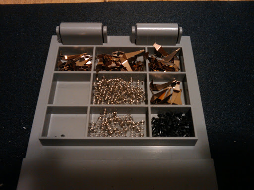

I have a few cautions for those of you that may actually attempt this mod.
Take the switches one row at a time, don't do them all at once.  They are the only thing keeping the membranes attached to the metal plate, so if you remove them all, the membranes could get out of place, making the 'board useless.  I'm sure you could get it back into place, but it's much more hassle than it's worth I think.
Also, be sure not to force the actuator leafs too much, if they bend out of place, you're basically all done.

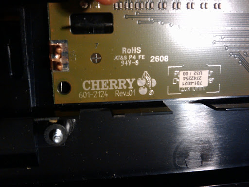

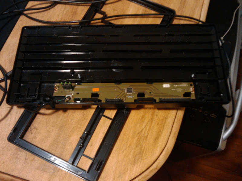

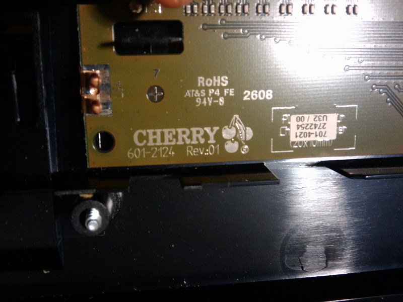

And this one's for you Itlnstln, I know you were waiting for it, the insides of the case:
Dunno if it's G80 compatible, I've never had a standard layout G80, but there it is.

how does hitting one of these keys off axis feel? That's the problem I Have with my FTSC boards, that hitting a key off axis the actuation force increases considerably.

It's not bad.  Even with the old springs in, it didn't increase the friction too much.  This seems to vary from 'board to 'board.  Probably how much it has been used plays a big factor.
Without the springs, you can't tell any difference between hitting it center and off center at all.
But yeah, I'm sure if you grease it up, it would be even lighter, which would be just nuts!
And after a day of using this, coming back to my cherry brown G80 feels like pounding away at white ALPS or a Model M.  No joke, I actually have to focus to press the keys down, it's nuts!

Finally got around to trying this mod on my G81-1800LUMUS-2.
A while back I tried it on two switches, and sorta liked it (it's not like MY switches can get much worse).
However, being lazy, I decided to use a quicker, more destructive method to remove the springs (not reversible).
Pics where taken around midnight, so lighting is crap.
So yeah, I didn't do all of the switches, left the spacebar as a heavy key. Along with the Esc, Enter, Backspace and Function keys.
Controller seems sorta big for what's on it.
Sharpie seemed like a good way to indicate which switches I didn't want to take off.
Switches before mod.
Leaf spring (a small flathead screwdriver, does work very well to remove these).
Leaf spring removed.
Spring removed.
Ok, so what I did:
  • Took a pair of scissors, and cut the plastic between the spring
  • Then just used a small philips screwdriver to fish out the spring (tended to get caught on the plastic remnants)
Still took a long time, but is less tedious (and you end up getting pretty darn fast at it, provided you have decent sheers).
What's removed:
All leaf springs removed.
All springs removed.
Overall, I think the mod is neat. The MY switches still feel like MY switches, just very light (not that I minded MY switches before).
A really good practice board for touch typing, as it shows you all of your bad habits of resting you fingers on the keys.
Another thing I've noticed. To actuate the keys I just let my fingers fall into the keys (with a little bit of force), and the switches actuate. This makes using the board, sorta relaxing, compared to say before, where you really had to hammer, or fall (with your whole body) into the keys, to get enough force in your arms, to easily get enough force to press the keys.
« Last Edit: Sat, 20 November 2010, 09:24:30 by HaaTa »

I'm studying at a German Uni. Today I opened a cupboard and saw a g81 staring back at me. Last night I read about this mod. That's great timing!!!
I've opened up the keyboard but am stuck at the hex screws part until I find a hex wrench from somewhere... I'll be trying out this mod for sure.
Question - what are the spring like? Are they the same as MX Blacks? Do any of you guys have some available for comparison? When I get my hands on an MX black g80 I'll try a ghetto red mod there by cutting springs.  If these MY ones are the same that gives me a safety net.
I don't really want to buy Cherry blue switches just for the springs...

These are Torx screws, not hex. A set of bits for the common medium sizes should get the job done.
