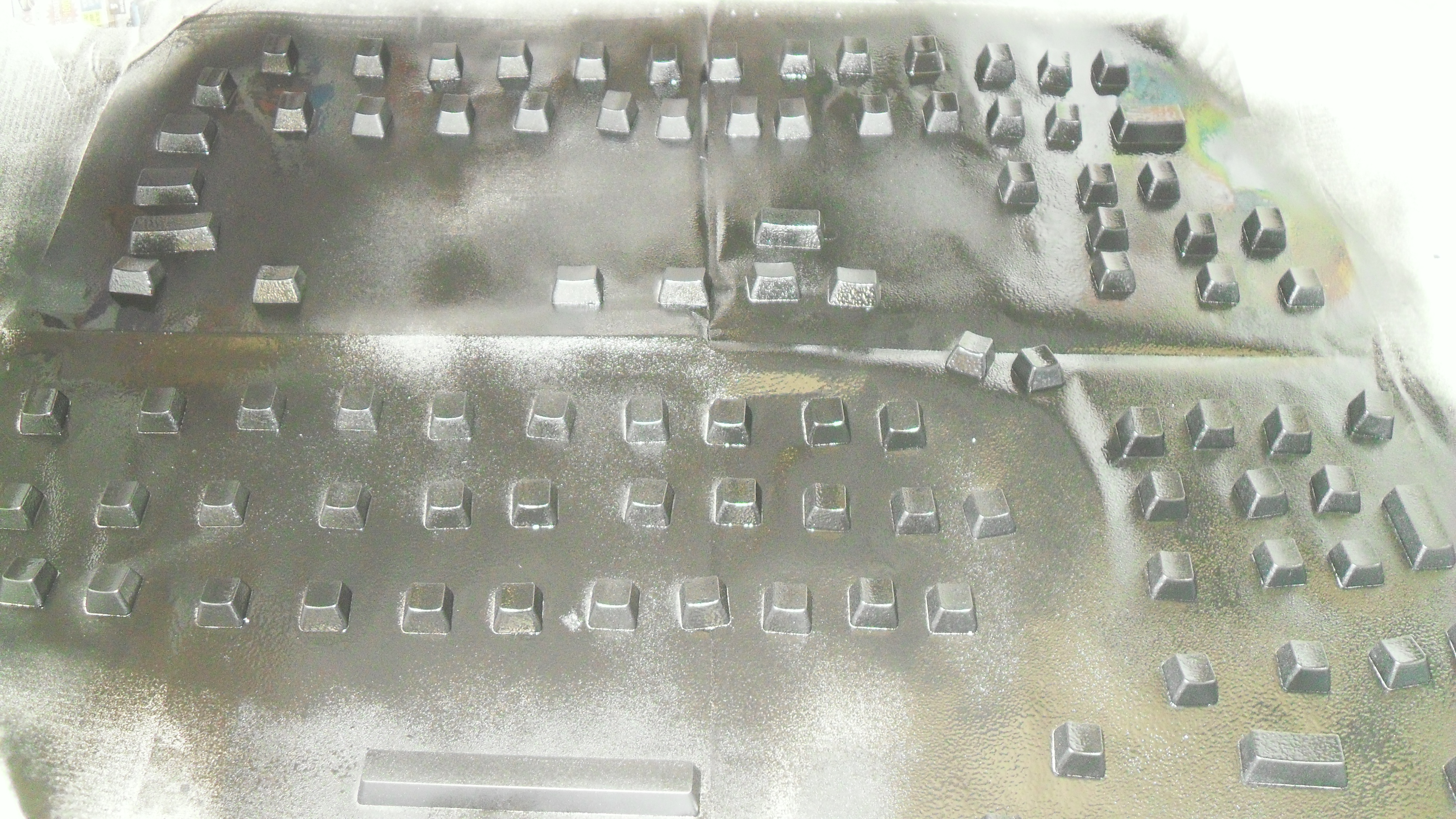

Welp, I decided to customize my keycaps on my 6gv2. I did it in 2 hours just a quick project.
I used Plasti Dip instead of rit or spray paint. I did some research on the nets and didn't see anything on Plasti Dipping keycaps. I dived in and it came out decently.
Used 4 layers on all the keys, only re dipping 13 keys (num pad) because they caught some wind and dried funny.

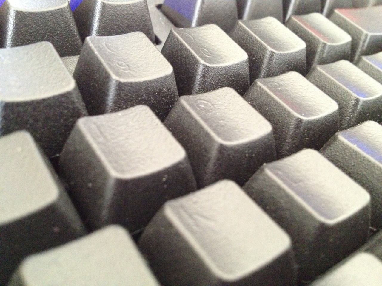

I particularly like how it dried, the letters show thru so its not totally blank. The Dip has a rubbery feel to it which i like. After a week the dip looses some of its "roughness"

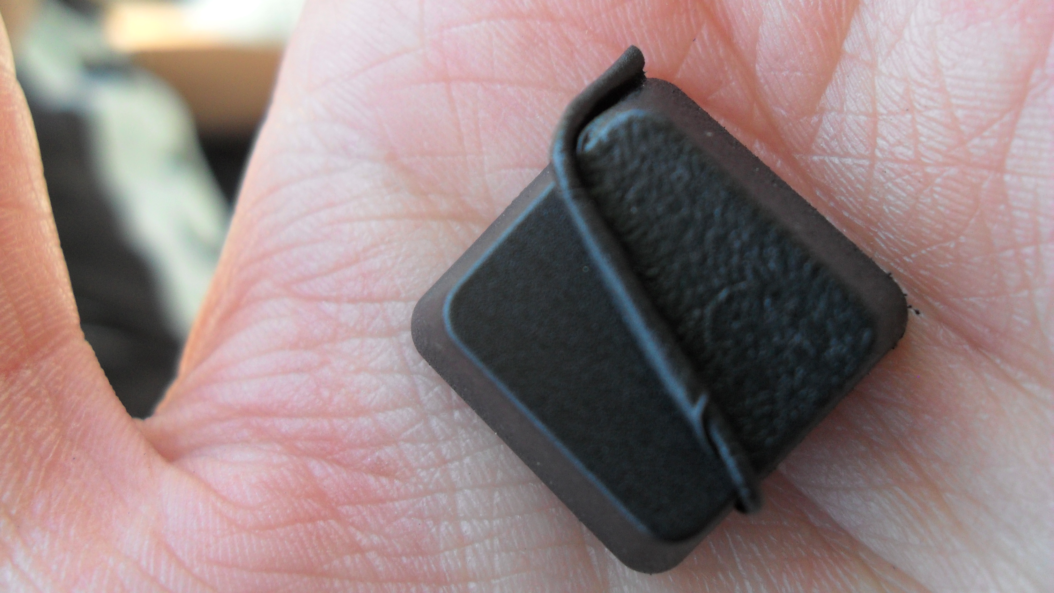

If you don't like how anything came out, you can just peel the dip right off no problem!

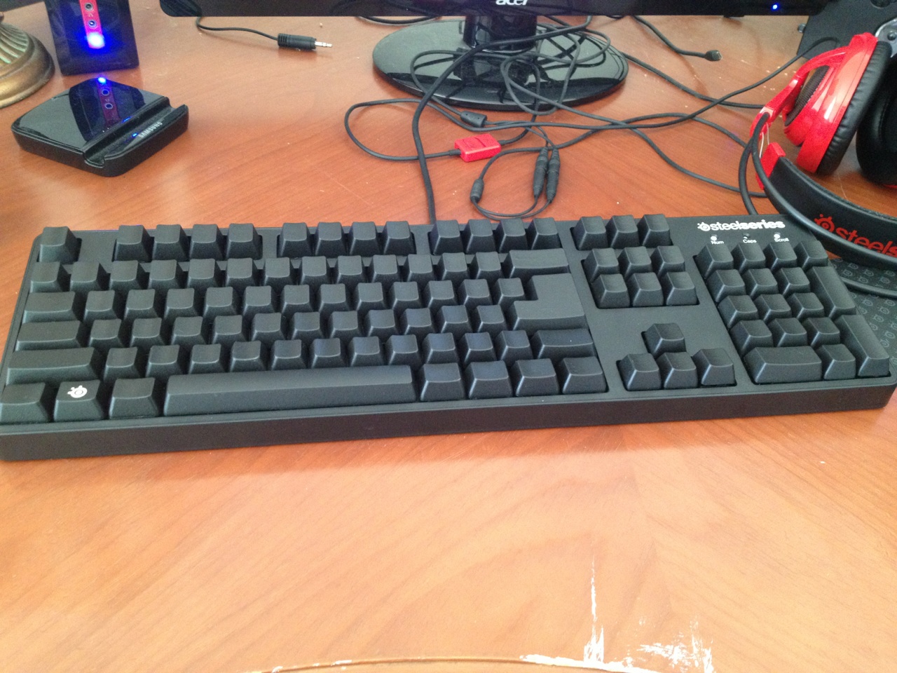

Cheap and easy way to customize your caps.
Let me know how you like it. Ill update if I have any problems, but so far this has worked out well.
