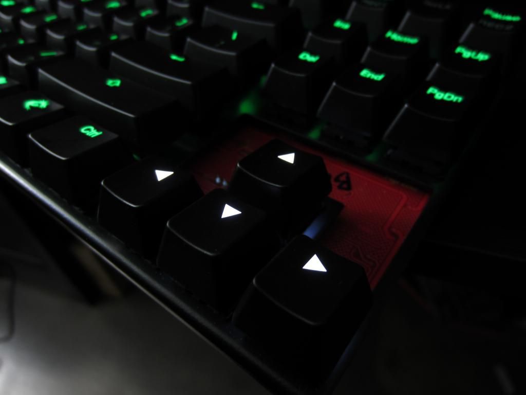

Offline WhiteFireDragon
  • Posts: 2276
    • youtube
Re: Custom LED Service
« Reply #3 on: Tue, 26 February 2013, 22:36:07 »
I've done this to my Ducky. Swapping out LEDs are harder than swapping out switches. They're smaller so it's harder to desolder, and more delicate. They have a lower temperature tolerance.
What colors are your current LEDs? Different LED colors require different voltage, which translates to different value resistor. It'll probably work fine if you swap in a LED color that uses around the same voltage so you can keep the resistor on there. Otherwise, you won't be able to change out the current resistor, at least not with 1 soldering iron. They're SMD resistors, so you need hot air to desolder both sides of the resistor at the same time.
  • Posts: 2276
    • youtube
« Reply #8 on: Wed, 27 February 2013, 01:07:59 »
I got the white one.
I got the exact opposite colors; green LEDs, and swapped out with some white ones. You should be able to go from white to a few green ones without needing to mess around with resistors, although it really depends on where you buy your LEDs and the specs.
Here's mine, one pic is max brightness one is minimum. Haven't had time to do some of the other keys yet. Desoldering LEDs is a huge pain the arse... more so than switches.
