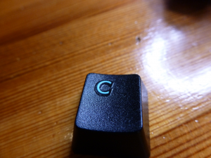

The keycaps are reasonably okay. They're pad printed and have a nice texture. The blue font actually looks rather good.

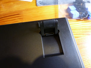

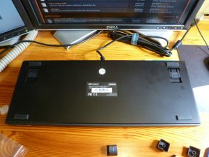

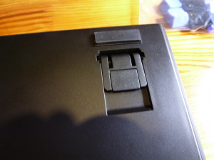

The board has 4 rubber pads, which do a good job preventing the keyboard from slipping and moving around the desk. There are 2 foldable legs with removable rubber tips. I've never seen such a construction before, but it seems pretty well-done.
There isn't much branding on the keyboard, only one noppoo logo in the front of the right corner and a label on the bottom.
The cable has a nice wire strap, which can be removed and used somewhere else too.

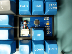

It comes with a translucent F12 key (there's a led under that key, but I don't know how to turn it on:D) and a pretty well-working plastic key-puller. After a few hours of using I noticed a second bag in the box, though. And this bag included a lavender arrow block, a blue WASD block and a red escape key. I'm not sure these keys come with the keyboard or qtan adds them extra, but it's certainly nice - it's 10 extra keys for a $90 keyboard.

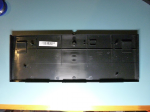

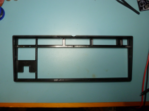

The interior of the bottom and top part:

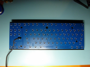

The visible top side and whole bottom side of the PCB:
33065-1133067-12
So I have to say the quality of soldering is very good. Now that I've opened it, I really can't say anything bad about this board. I definitely recommend it.

The case seems to be the same as the Filco one. Also the foldable legs with removable rubber tips are the same on Filco.
If you still have trouble to open the case, pls check out ripsters guide "how to open a filco". This might help a lot.  :)
