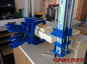

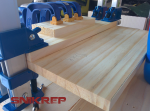

I started off cutting the wood down to size:
* One 10" x 14" for the base of the WR
* One 4.5" x 14" for the rest
I glued these together and clamped them together for a single unit, base and rest.
64918-0
64920-1
Since this is meant to be a build log, I will post more pics when I take them and update here with a new post.
Enjoy the start for now and as always questions are welcome.
