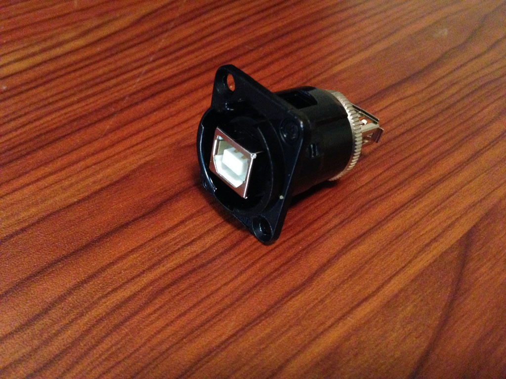

I got the Switchcraft Panel Mount Connector - USB B to A in sweetwater

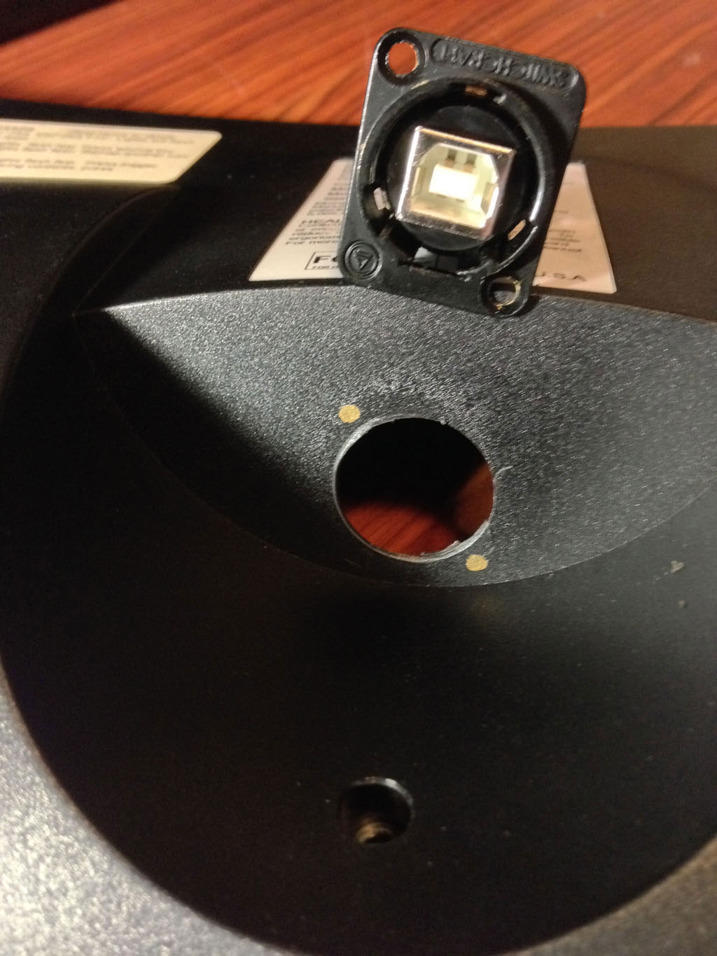

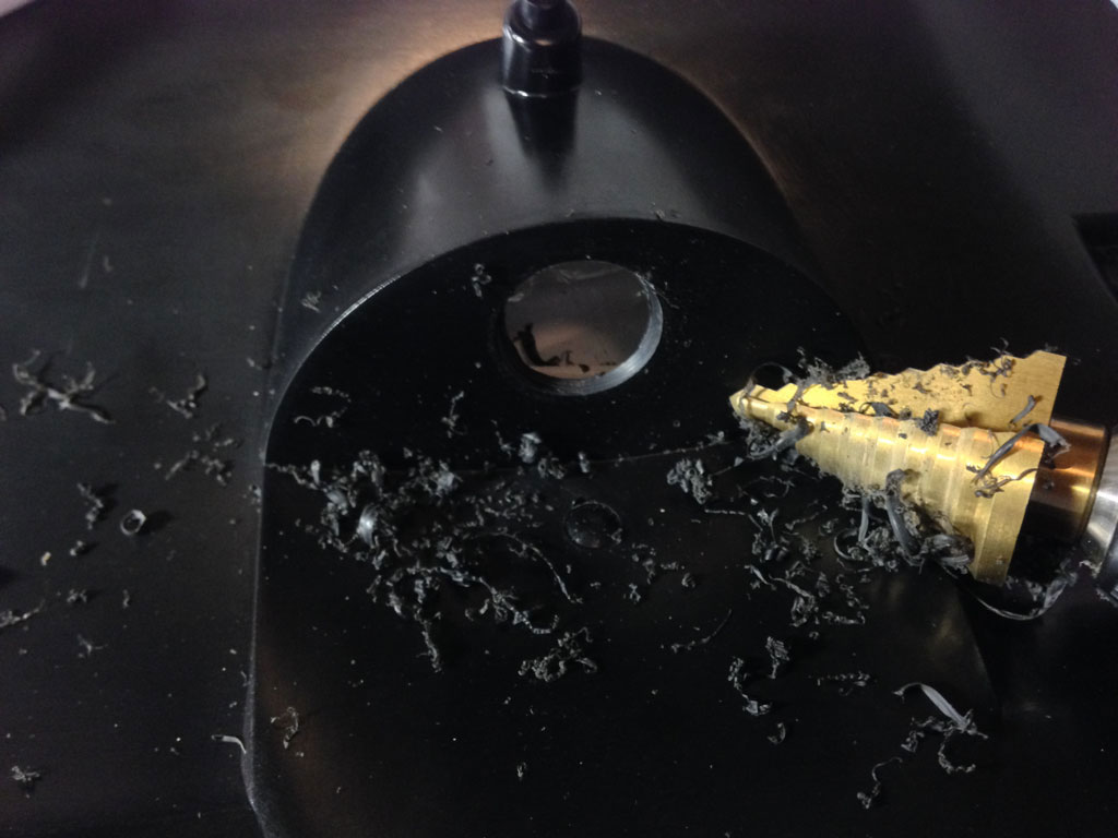

step 2: remove the cable from the casing, and use a step drill to make a hole until the USB connector fits

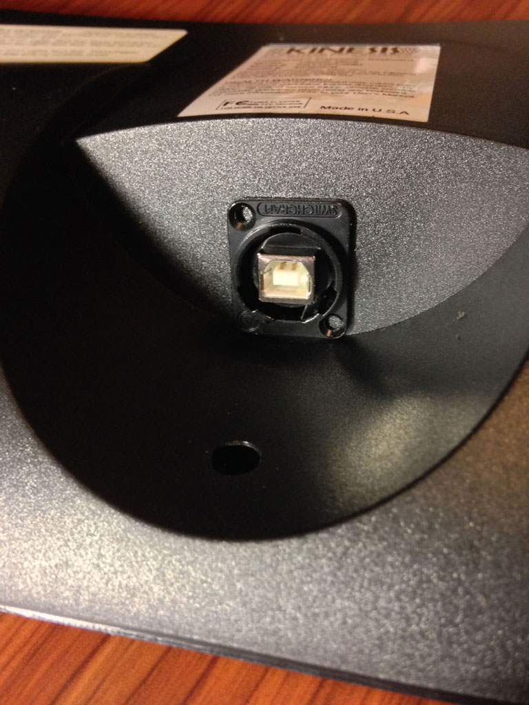

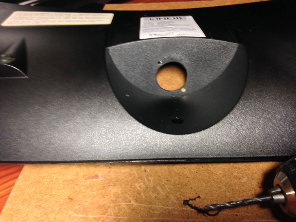

step 4: drill the holes

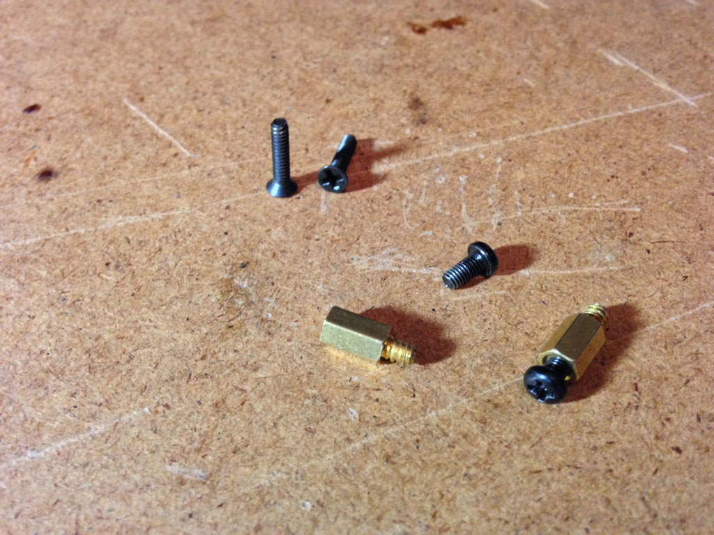

Now, since the original screws had no nuts, I had to replace with something I already had at hand. Luckily, found some black screws that fit on some type of nuts :)

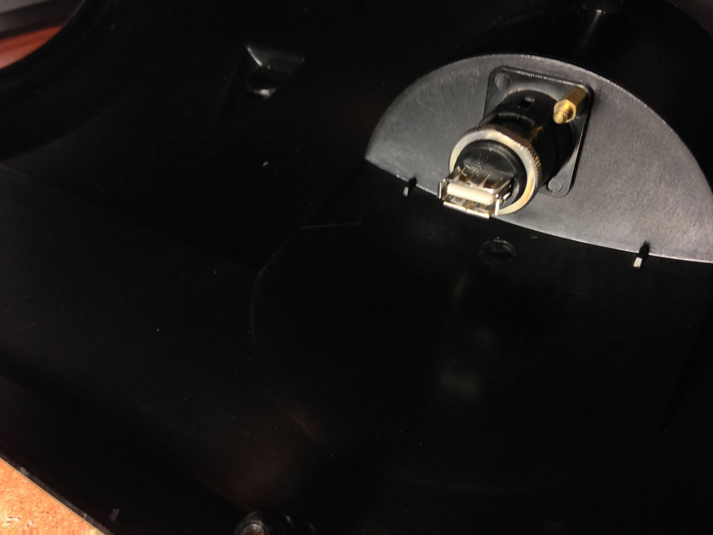

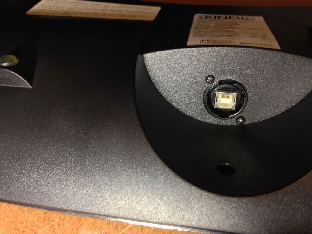

Step 5: Screw the panel from the inside
37631-737633-8

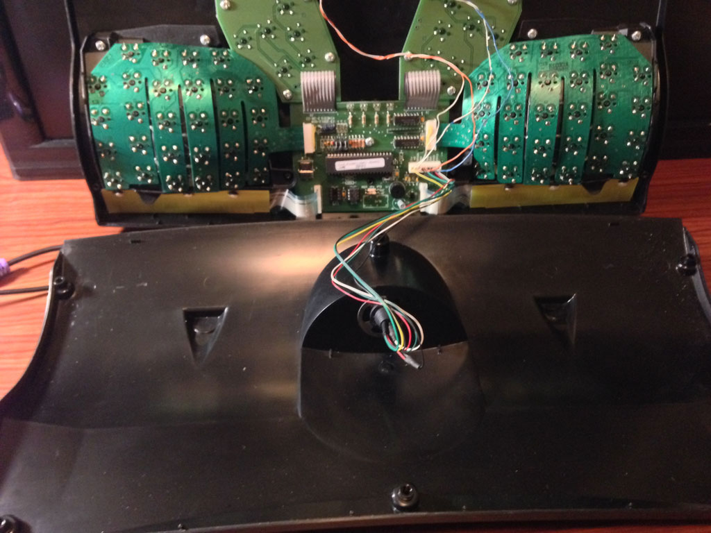

Now, the point of no return:
Cut the original PS2 cable, and keep the parts shown
37635-0
Glue together the ground and black cable
37637-1
Solder the cables together, only the PS2 cable ones, the others go to the Pedals, and I have future plans for those.
The Laffy Taffy is in top of those pedal cables.
37639-2
37641-3
Put it back together, with the PS2 converter. (You can see my cables from doing sordna's palm keys modification http://geekhack.org/index.php?topic=26579.0)
