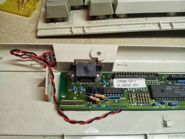

I am using the USB adapter sold at Clickykeyboards (although I didn't buy it there), and while it usually works fine, sometimes when my laptop wakes up, the keyboard isn't responsive. Typically, I was just unplugging the cord from the back of the keyboard which fixed it. I've done the pull-up resistor mod, but it made no difference. So, I added a simple pushbutton momentary switch that connects between pins 1 and 2 (Vss and /RST) of the 6805 controller. It works great!

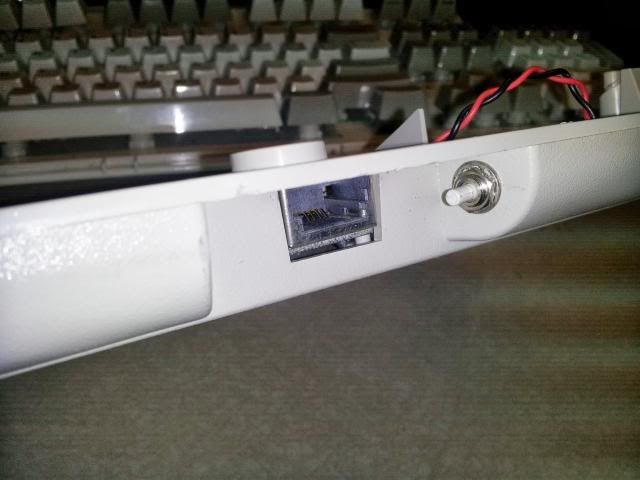

Nice and clean, and won't accidentally be hit:

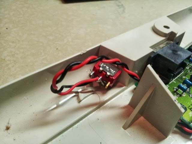

Soldered to the back of the board, sorry, no pic. It was a bit of a pain but it does work:

I actually bought a nc/no switch, thinking I could splice it in between the +5v line with the N.C. side, but with everything on-board that was too difficult. Fortunately, I was able to use the N.O. side on the reset pin.  I wish I knew why this was necessary, maybe it's a problem with the adapter, or the usb port, but I'm satisfied with this fix for now. As long as you don't mind drilling a hole in your keyboard...
