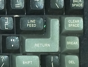

Couple of notes, for anyone thinking of using Futuba switches or Televideo keyboards:
1. The switch pins/lugs/screws transmit heat really well.  I found this out the hard way - when I'd finished soldering the top row of switches, half of them wouldn't depress fully, switch stems were binding and sticking.  Taking a switch apart I found out why - the inside plastic of the case was partially melted, warping the channel for the stem slider.  Damage doesn't show from the outside, the pin conducted the heat from the soldering inside the switch case.  Sure glad I bought some extras...
2. Whoever designed the Return key is an idiot.   Notice that little "ear" that sticks up from the keycap, to bridge the gap between Line Feed and Clear Space?  Yeah, that's just for show.  If you actually try to depress the switch and your fingertip is on that section of the keycap, it doesn't work, the key just binds.  Don't even get me started on the fact that this keycap is a different profile from the rest of the row...   :mad:
39607-0
