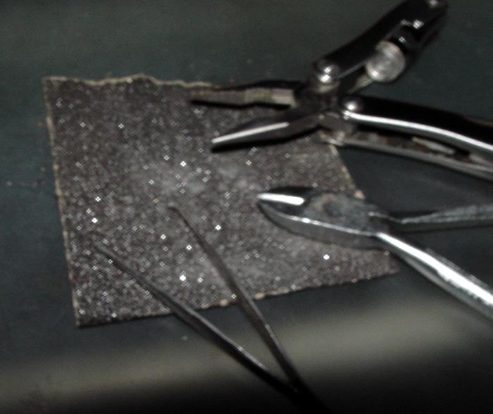

You need small pliers and small cutting pliers + sand paper :
51666-0
You then need to fold the tweezers at different points to get the perfect shape, able to go in between 2 keys without scratching plastic, and able to pull off a key with no pain, the best way is to use a crap keyboard to test your tool while shaping it. You may need to cut the curved end of tweezers so it can pass throught 2 keycaps.
Last, you will need sandpaper or a metal file so that your tool has no cutting edges and won't scratch platic.

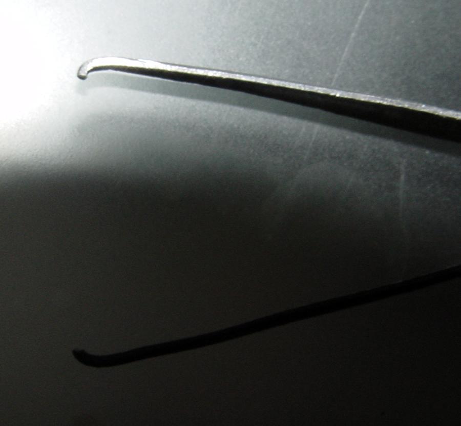

Here is the result, it took me about 10 minutes and works like a charm, even on an ALPS keyboard where keycaps are really hard to remove :
51668-1
Hope this may help :)
