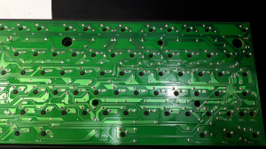

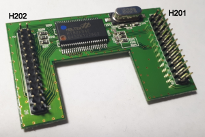

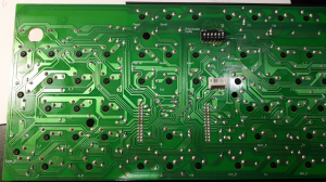

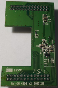

Then I had decide to make own custom controller. I have made reverse engineering of board wiring. Keys board has two header-connector for controller board.
229654-0229656-1229658-2229660-3
229662-4

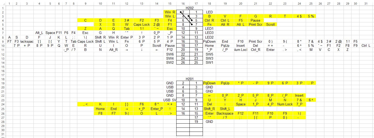

Totally, this keyboard has 8 rows and 18 columns. I decide to union Win_R & Win_L single columns with other. It reduce columns to 16. In addition, board has 6-key DIP-switch to configure (layouts, mode…) and 3 led.
Total 8+16+6+3=33 I/O ports. It is too much for typical Arduino/teensy boards. It can be reduce by using bi-directional multiplexor. 8 rows can be reduced by 74HC4051 to 3-bit line. 16 columns – to 4-bit line by 74HC4067.
So 3+4+6+3=16 I/O ports – it is enough to choose any arduino/teensy compatible board.
