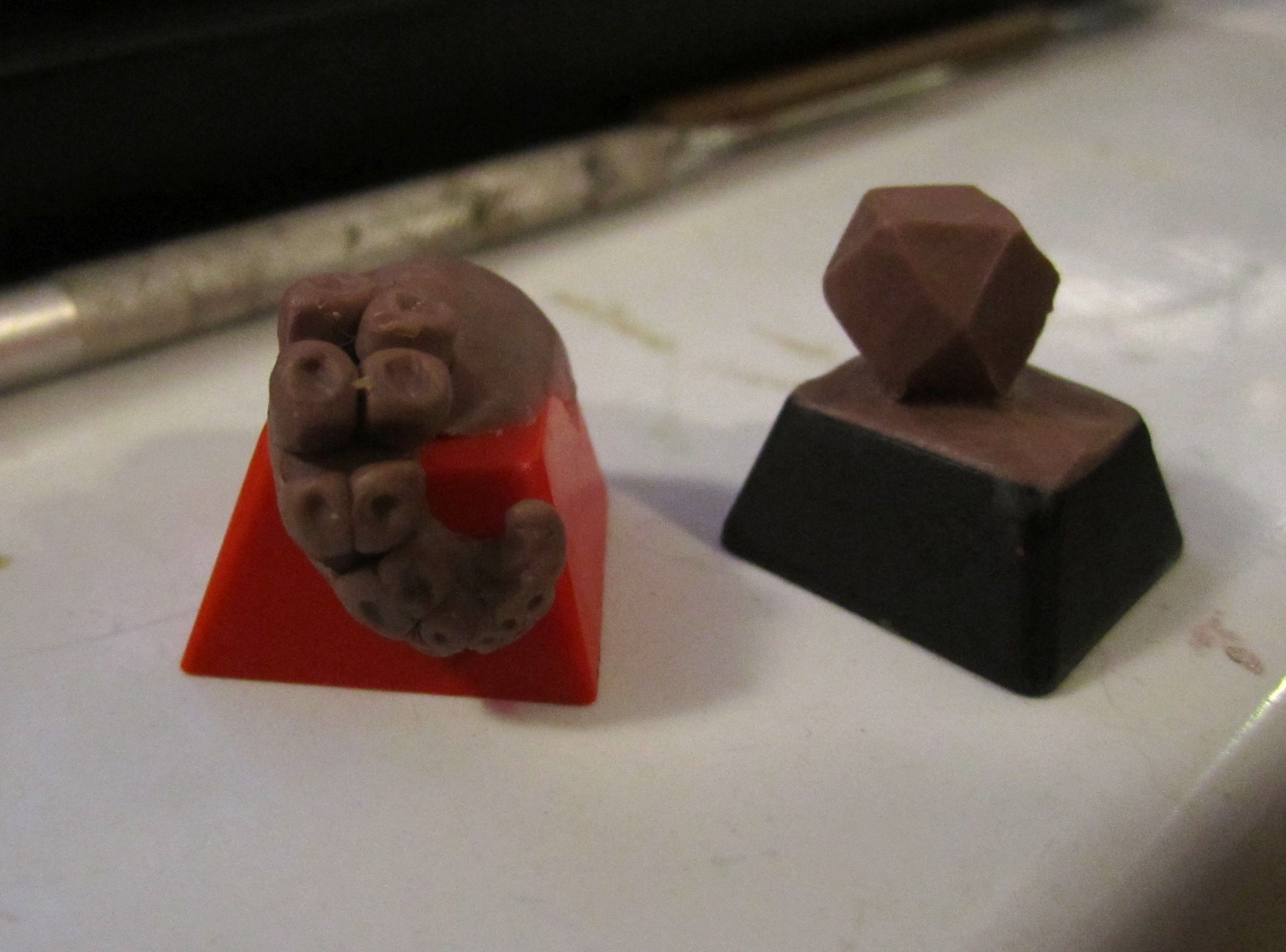

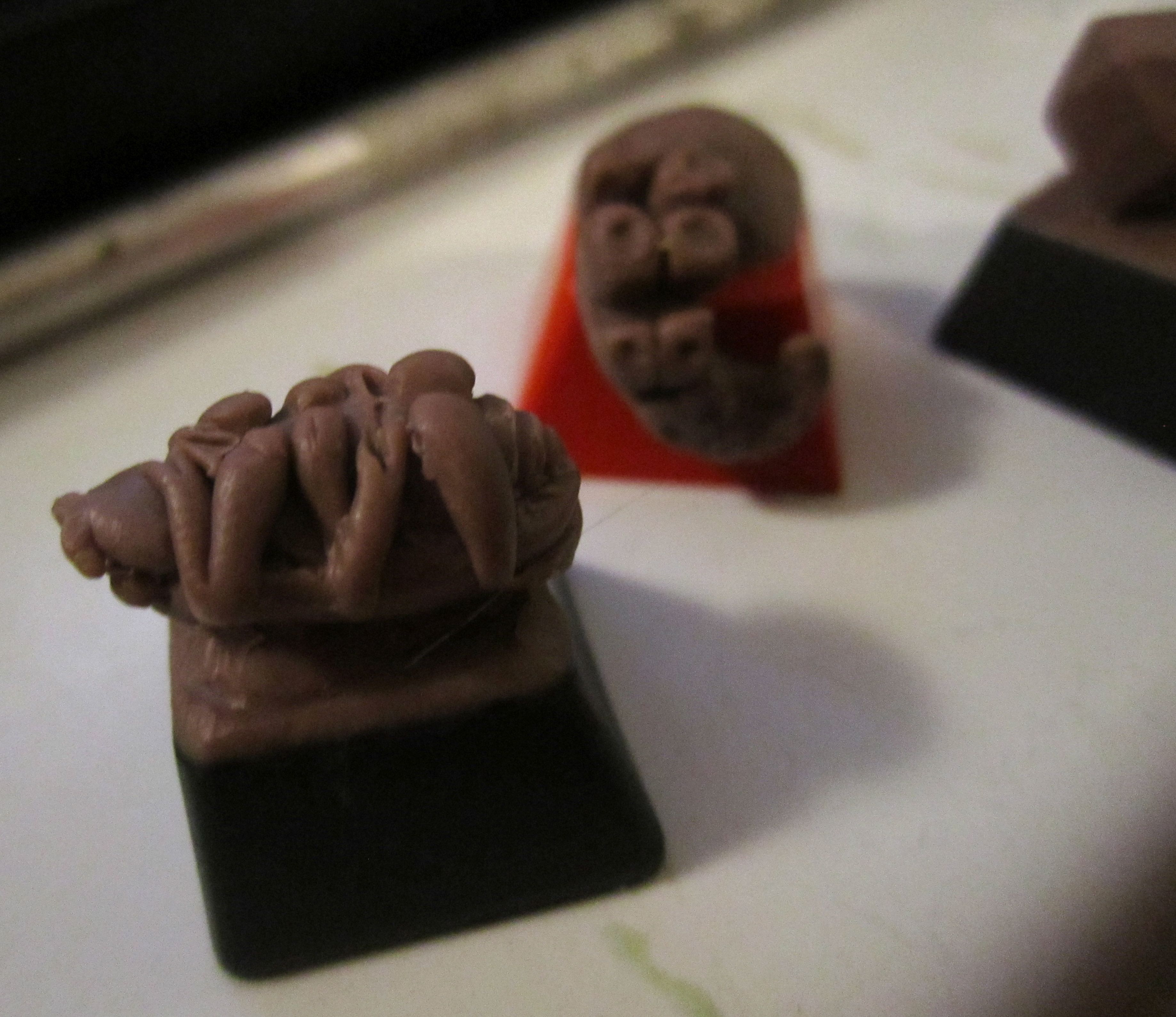

So, the clay came today. It's a lot like wax in some ways but more melty. It's not sticky, which is annoying when I *want* it to stick to a key that I'm using as a base. I'm very happy with the way it smooths. The same clay tools I use for miniature work work very well. No, smells and I can work forever.
I may give the green stuff shot next. I'm still coming up with ideas for "ways to sculpt a key" this better clay opens a few more possibilities. Here are the first few things I made.
62779-0
I'm happy with the crispness of the edges on this polygon. It might even be smooth enough to polish after casting!
62781-1
The legs on this beetle took a long time. I still don't think I'm done. It needs too be crisper...
As for the tentacle? It will be a part of a series.
If the green clay is even better than this stuff I'll be in heaven.
Those are some really nice caps. Not sure how functional that tentacle cap would be, but it looks awesome! ;D
