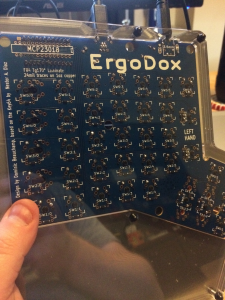

Whee, look what showed up in the mail from Massdrop!
65839-0

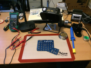

Progress after the first night. I got my work area setup and soldered the first 15 surface mount diodes, I actually spent a couple hours practicing on a surface mount practice kit I found on Amazon before diving into the Ergodox. I was happy I did, it was a complete writeoff but it let me get comfortable with the tools.
65841-1

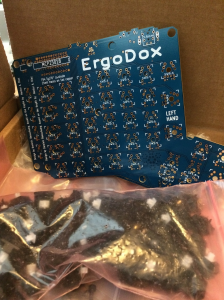

It's alive! First full test! I did some basic tests with just a few keys soldered on to verify the Teensy worked, the I/O expander worked, and so on.
65843-2

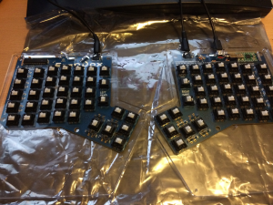

Keycaps! I had to improvise here and order some temporary caps earlier in the week because the Massdrop kit shipped earlier than expected and my caps from the Granite groupbuy aren't here yet.
65845-3

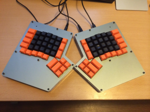

One last shot, inside the belly of the beast. If I can do it, you can do it.
65847-4
